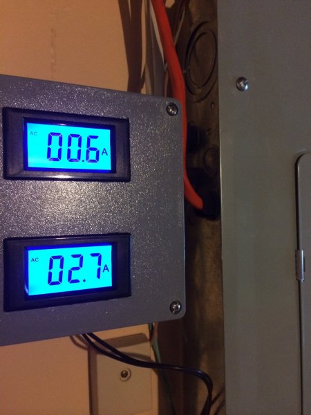

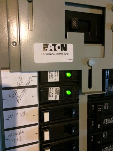

    Got whole house surge protectors to protect oil furnace in breaker box. :)
    Also got current meters to monitor the draw. :)
    Power in watts = I (current) x V (volts)
    Since we only have the TV and a Ceiling Fan and 1 desktop and 3 lap top computers on this morning:
    Current draw this morning is
    2.7 + 0.6 = 3.1 amps
    P = 3.1 x 117 = 352.7 watts
    Since the units used per month are based on time on the electric bill 1 unit is 1 Kilowatt Hour (KWH).
    Example:
    A 100 watt light bulb left on for 10 hours is 1,000 WH or 1 KWH = 1 unit on the electric bill
    Our Electric Rate is 0.15487 dollars per KWH.
    Divide by 100 to get approx 15 cents per Kilowatt Hour!
    So if we only used 352.7 watts all day for 12 hours
    352.7 x 12 = 4,232.4 watt hours or 4.2324 KWH
    That would cost
    4.2324 x 0.15487 = 0.65547 dollars or multiply 100 to get 65 cents!
    This does not count all the other charges and surcharges though!
    See 2nd pic
