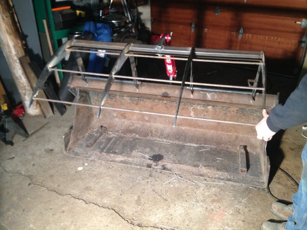

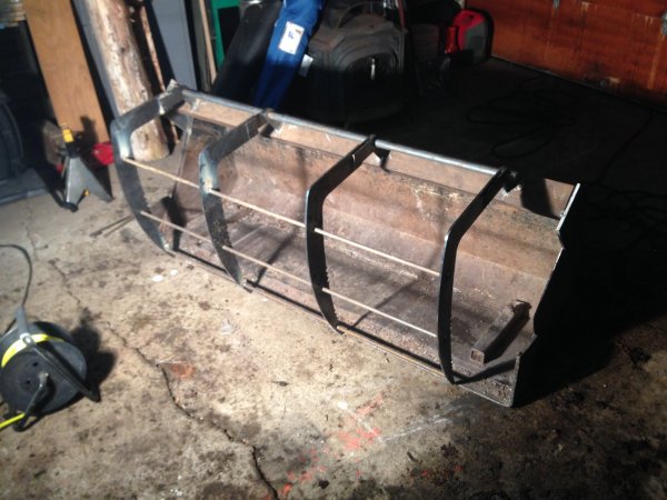

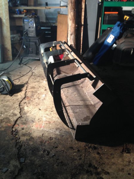

    So tonight my step father and I started building a grapple for my tractor. Mainly to haul brush out of the woods. I'm sure it will serve other purposes too. Well here are some pictures. I know I know, everyone hates pictures. image.jpeg image.jpeg image.jpeg
    I had the arms programmed at work for our CNC controlled plasma table. I love having connections.

    Your pics suck!:rofl: :lol::rofl: :lol::rofl: :lol::rofl: :lol::rofl: :lol:
    Your grapple is terrible........terribl-Y AWESOME!:rofl: :lol:
    And of course, plasma cut parts suck, too:thumbs::rofl: :lol:

    I am impressed with what you have so far. I am sure you have a plan on how to open and close the grapple and will be interesting to see it when done. Keep showing those pics.

    Looks good. Are the teeth going to be replaceable?

    No, the teeth won't be replaceable. If/when then wear out, I'll have new arms burnt out and replace them.

    Looks awesome. I am very interested to see how this turns out. Greta work so far!

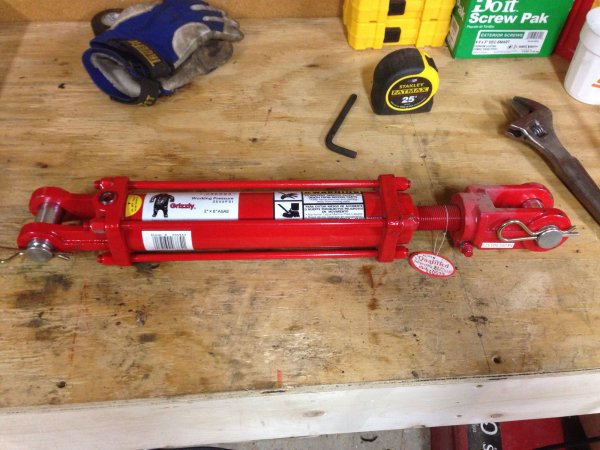

    Very nice RParrotte ... looking forward to seeing how it's linked up to your ram.

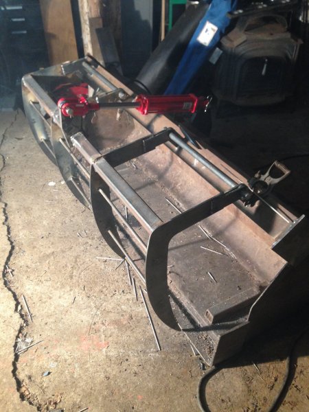

    A little more progress tonight.

    Almost looks like it should open about another 10 inches or so.
    Looks good though. looks real good

    We still have a little playing around with the cylinder to do. Limited space to work with.
