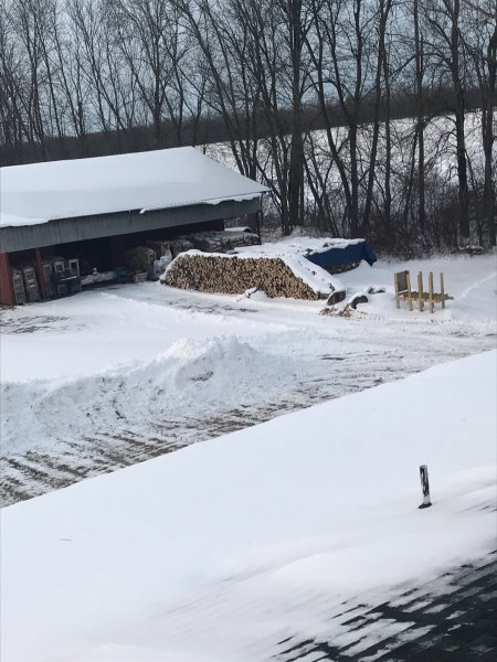

    I didn’t take pictures but the IS is keeping it nice and clean. Now if I only had a wood collection like yours!

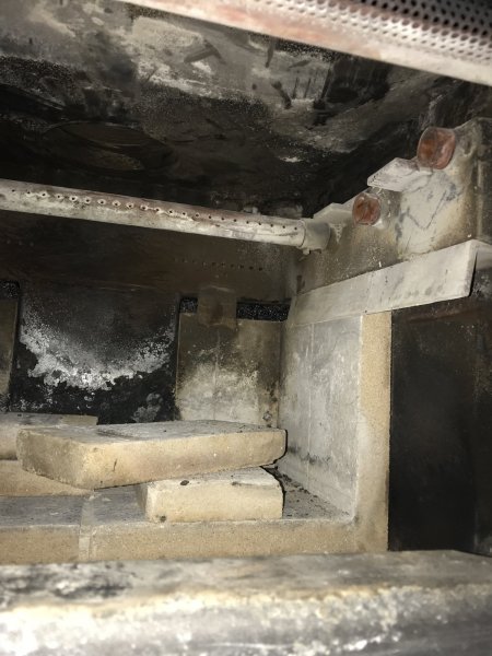

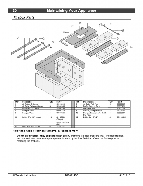

    Start disassembly and cleaning. Remove the roll pins to get the secondary tubes out. Then push up the front two fire brick and remove the front steel baffle. The ash on top of the upper bricks can build up and hinder the bypass so I cleaned them up good. 18C29CBA-774F-4D38-A1F9-ED7110E27D98.jpeg

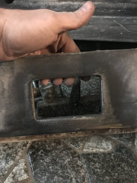

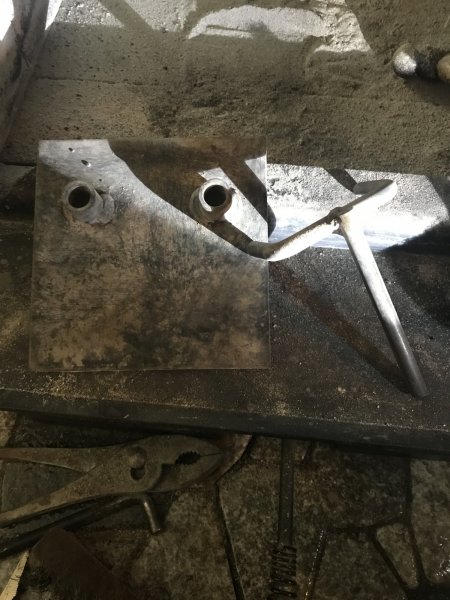

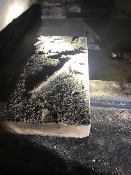

    Then the back two bricks and center baffle comes out allowing access to the baffle. Here’s the culprit!! B4FEA076-B633-47B3-A788-8E82089C0746.jpeg After the bypass is out you have to pull the floor fire bricks out to make room to remove the rear steel baffle. I got it out took it out to the garage and between the grinder and wire wheel got it cleaned up a bit ADA5B5F3-8352-49A8-9F99-A8255E6991BD.jpeg Knocked off the sharp edges and cleaned everything out good. 0B261F73-BFDD-4AB9-9AEE-BDE490F114EA.jpeg Start putting it back together and looked at the upper steel baffles and noticed they are sagging a bit, I’m guessing from heat. The bypass rides half on the rear fire brick and half over the opening in the rear baffle. What I notice is that since the baffles are sagging it allows the bypass plate to tilt when it gets over the bricks. This seems to cause the worst of the jamming which is worse when it’s dirty. I think I’ll invest in some new steel baffles or try to square these up some day. For now I put it back together and it seems a lot better.

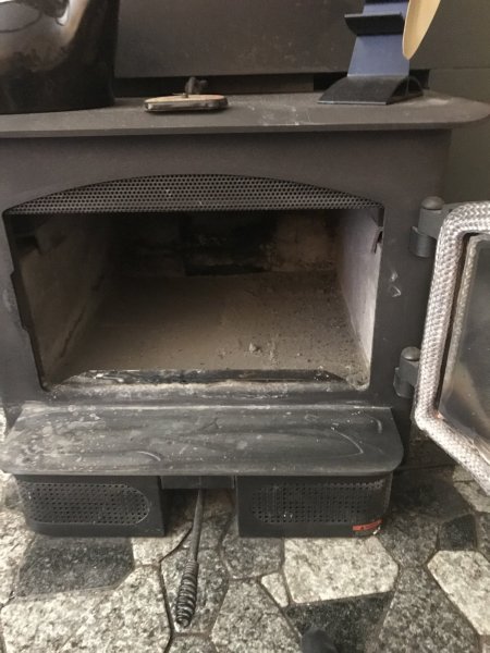

    While I had it tore apart I also removed the blower assembly to clean it. Let me just say if you have a blower on your stove take it off and clean it! Holy dust bunnies!!! Blew it all out with the compressor and the whole set up is like new again! Just in time for the weekend deep freeze that’s on the way!

    Apparently our stoves are not the same, I didn't know that the insert had a bypass in it, my free standing does not have it.
    The only time I ever took that big baffle plate out of the back was when I wanted to lighten the stove to bring it in the house.
    Are you talking about the baffle (brick) supports look warped?
    Those look straight to me on mine, the secondary tubes are sagging a little tiny bit, not a problem though and it is to be expected.

    Hmmmm....:sherlock:that’s pretty interesting ! I always thought the free standing and insert were just the same! As far as the sagging pieces I’m talking about reference #4, #5 and #6. The worst being #5 and #6 which allows that rear set of bricks to be much lower and cause a funny angle on the bypass plate #7.

    I have similar brick ledges in my Napoleon 1900p, and I've had to massage them with the hammer and anvil before. I think it'd be fine to do that given you don't go "overboard"....
    Chances are those pieces are stainless steel.

    I also have a Lopi Liberty which has a similar internal design to all of our stoves. The baffle supports are known to weaken due to heat. They may scale and sag but that’s all dependent on use and burn habits. They’re steel and can be replaced with oem parts. There was a guy on ebay making supports and tubes for Travis stoves.
    I rehabbed the Liberty from a Craigslist score (2002 model) and noticed the baffles and cracks at the corners around the baffle and secondary manifold. I had my welder buddy make a new center baffle support. Good quality angle iron and a steady hand is all ya need. I think my dealer’s list price was $70ish.
