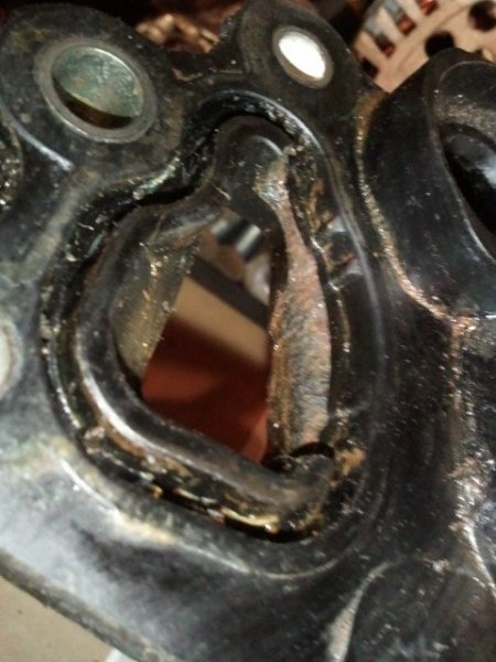

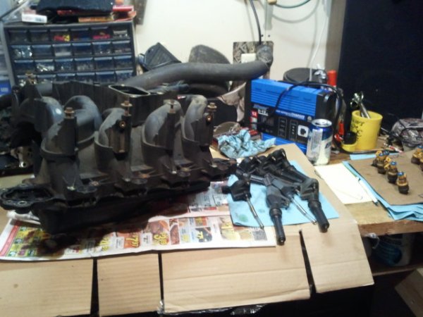

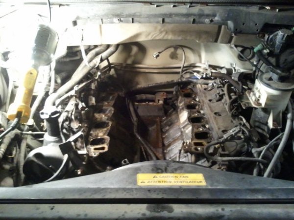

    My truck has had a coolant leak so it hasn't been driven for a while. (I miss her, never should have got a car :() So I thought it was time to try find the leak and get it running again, tired of borrowing my son's truck. So pulled it in the garage and the neighbor and I started digging in. Looks like I need a new intake manifold because a little piece of plastic broke. While I'm at it I might as well put in some new plugs and maybe a couple new coil packs. A couple closest to the leak had fouled up... Time permitting it may be up and running by next weekend !!!

    Pretty much have it all ready to go, just need to find some parts and see if I can do it cheap from the salvage yard or if I have to go to the auto parts store. I guess this will be my Christmas present :cheers:

    4.6 Ford?
    If so go new, the new one has aluminum on the front water passage where the t-stat housing it's which is where it cracks most of the time. Those composite intakes are a ticking time bomb after 100k.

    2,041
    yes.. don't buy a used one and go through the hassle of changing it and having it leak again. the new ones have the aluminum to keep them from melting and warping from heat.

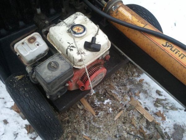

    Since its running, I thought I should give it a little test.
    But then, of course it goes back to the original title...
    Nothing's ever simple... Looks like I have another project. A little recoil work to do :axe:
