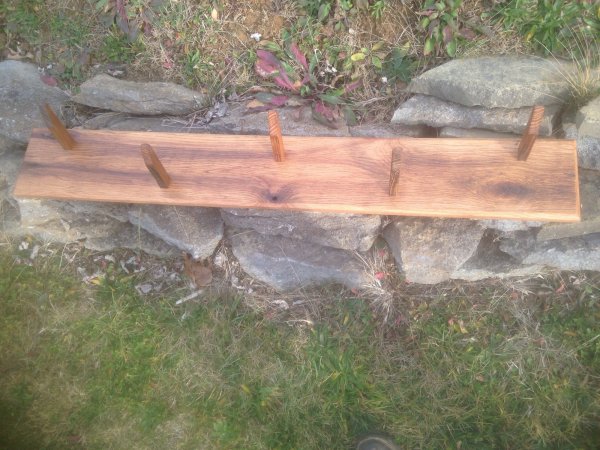

    I saved a bunch of oak lumber slated to be burnt in a huge Bon fire. In fact I was able to get two fully loaded truck loads of it.
    96% was oak true 2x4's while the rest was various planks and odds and in's
    I really don't like burning oak it's such a beautiful wood it's hard to burn something so pretty plus I do a lot of wood working
    Without boring people any more my wife wanted a simple coat rack so I made this for her It's obviously oak lol with tobacco stick pegs for the hangers. With a chemical free finish

    I've worked with some old salvaged oak building 2x's and it seems that they pick up a little different character/color over time. The stuff I was working with looked just like Chestnut (and your projects) when finished. I wouldn't burn it either brother!:thumbs:

    Well of course you can't burn oak lumber when it cleans up like that! Nice work my friend :thumbs:

    I actually used bees wax for the finish. It's easy to apply and the best part is your not getting high doing it. But it goes on fast takes very little to do it too. I think barely used 1/4 oz if wax on this
    Dries fast too. It looks better in person than the pictures. My phone case is dirty so the pics don't come out that well

    What do you mean by "tobacco stick pegs"?

    The coat hangers are made from tobacco sticks. Not being a smart elic but I just noticed you live in Canada maybe this will explain it better
    Tobacco sticks are readily available here. They are made of hardwood and they very in shape. Some are machined shaped and some are hand shaped. It's hard to explain lol

    I'd like to know a little more about this Beeswax finish... What can you say about prep and application?

    Well total time in doing the piece was about two hours. Beeswax is easy basically I ran the piece through the planner. Routed the edges and did just a little light sanding. Cleaned it and applied the beeswax. It took about 1/2 oz if beeswax to do the whole thing. You apply it with a rag and it's like waxing a car only I didn't buff it. Once it was on I set it outside for about a half hour and it was dry. The pics above was when it was drying.
    The best part is you don't get high doing it chemically speaking but a high from looking at how good it brings out the grain

    Beeswax is good for inside application of the piece is going to be outside I would use the standard finishing products for outside
