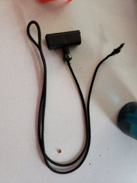

    Didn't really feel like splitting today anyway.
    I know its an easy fix but still an excuse not to start the splitter. 20220926_154649.jpg

    Looks like that one has some miles on it.
    Just FYI, when they fray/pull apart like that its usually from the cord being too short...they don't like that sudden stop when you get to the end...when replacing I always wrap as much length as I can on the pulley so that can't happen as easily...5-6' if possible.
