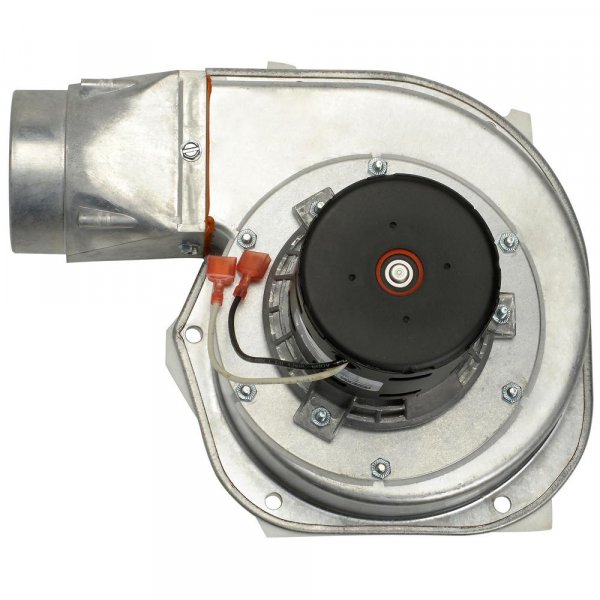

    If your exhaust fan looks like this piccy...
    These have ball bearings.
    Remove the 6 retaining nuts around the periphery of the motor (DO NOT REMOVE ENTIRE HOUSING)
    The white high temp gaskets are generally a one time use, and will tear apart when removing the motor...hence, keep a hand full on the shelf.
    Once you get the motor out... plug the wires back in, plug in the stove and with the motor blocked so you can watch the fan ...start the stove to see what the fan does
    SPEED is important..
    Little speed will not move much air.
    A clogged fan and housing will yield the same issue.
    PICCY'S PLEASE
