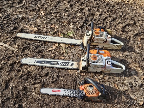

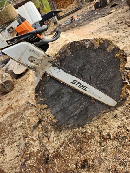

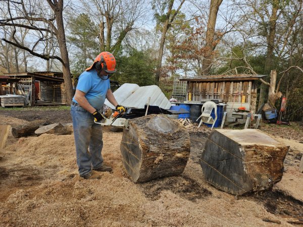

    Oodles of noodles, not Ramen, but white oak. Finally got around to working on that big knotty white oak the blew over in Hurricane Helene.
    Used the Stihl MS461 32" bar, Stihl XS400, Echo XS2511T to mark...

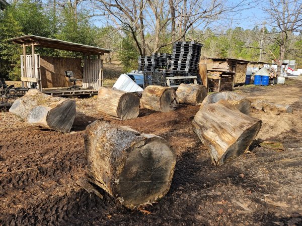

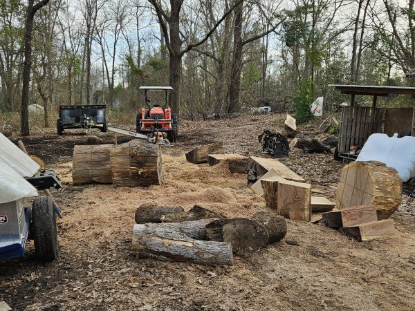

    Making progress, Kubota L4802 and MTL grapple made moving these big rounds around easier. 20260107_161152.jpg

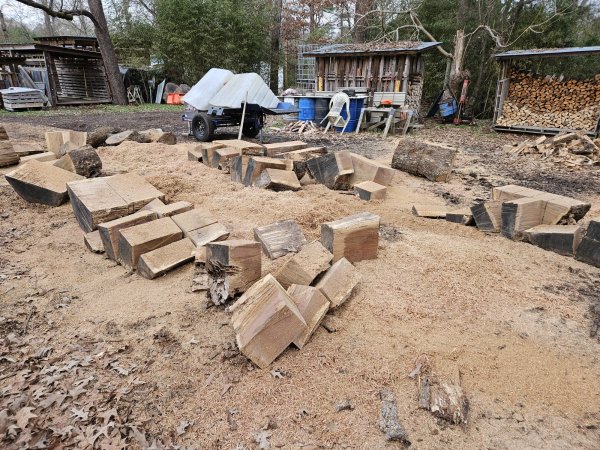

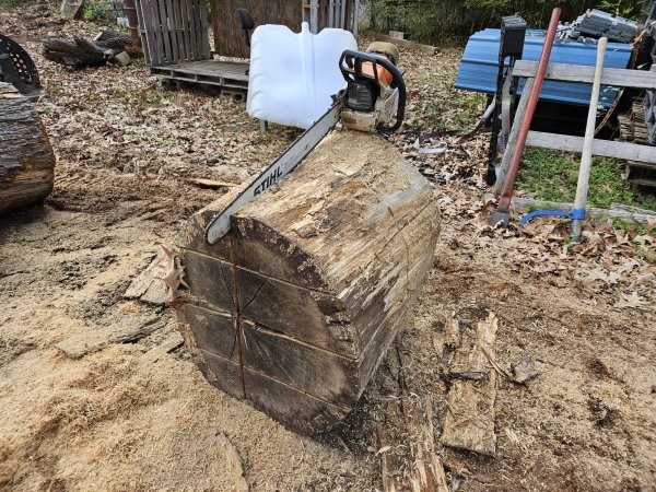

    We cut the rounds 14" and 18"...still got some smaller pieces to cut, got it down to handling size... 20260107_170453.jpg
