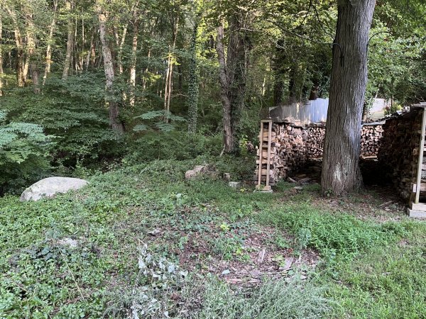

    I feel that I had Norway maple before that took more time to dry than I expected. More recently , I processed a bunch of it in November 2024, so it’s been CSS for about 8 months at this point. For fun, I took a couple avg sized splits from 2 stack. One with the best position in the yard that gets some sun- the other that gets little to no sun. Both stacks are top covered with metal roofing. The split from the “ better” stack came in the mid 20’s MC and the other came in about 29 percent.
    I’m not burning the Norway maple this winter most likely, but was curious if these numbers seem a bit high for 8 months of drying time. New England has been pretty dry as well so I was a bit surprised.
    I had been a bit more ahead on wood in the past. I probably have about 1.5 years worth currently with most dry. Will be working on getting another 1.5 cords processed before winter. That will likely be my limit for space. I reconfigured my stack over last few years. I transitioned away from using pallets to using PT racks I built. Wanted to neaten up the area and minimize the annoyance when/if a stack fell over. I attached a pic of the current back row. Put a pic of Nolan the dog for fun presiding over the front of the stacks.

    I usually compare Norway maple to ash in terms of drying time and btu output. It does seem high IMO. I don't have a MM and just go by time in the stack once SS. Check it in four months and let us know.
    If waiting til 26-27 to burn I wouldn't worry.
    I like the new stack arrangement Steve! :thumbs: Once I went to built racks I never went back to pallets for the most part. Looks like Nolan approves too.

    Just going by one picture I would say your mistake is by stacking wood under trees. That is a sure way to slow down the drying time. You will learn from this and the future will be brighter for you. Just get the wood more in the open and definitely not under trees.

    Good call. The shade definitely slows things down. This area is the most feasible overall for the wood storage. I’ve been using this area for about 12 years for storage so I’ve been accustomed to the slower drying rate. I think I’m just noticing more with this bit of wood. I bought it from a log load and I wonder if he had cut it during a time of higher sap content.
    I’d love to have more space but I’m on .5 of an acres and the place has never been ideal for wood stacks.
