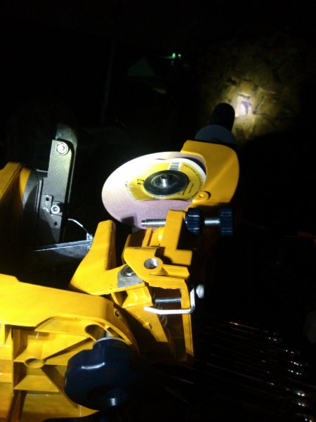

    Was grinding a few chains monday when I heard a pop and felt it as well. I could not tell what it was and just went on. Then I quickly realizes the head was not moving up and down correctly. And it popped again as I moved it again.
    Turns out the pin that holds the head to the base backed out of the right side and the spring then leveraged the head up and away from alignment and each move allowed the spring to "unspring" a little bit more. The spring is so strong I cannot force it back into alignment. So I called customer service and got a return number. I will carry it back to the store and await my new one to be shipped to me :(

    Here is the unit. Look at the hinge area. See the shiney metal, that part should not be seen. It should ride under the part that is lifting away and that about 3/8 pin should be driven through both sides.

    Nope.. Mine did the same thing... Take the pressure off the spring and line it back up, and tap the pin back in... I just keep an eye on mine now.
    Probably 250-300 chains through it by now.. Can't remember what exactly I did, but it was no problem..

    I guess I could of tried to mess with it bit it was under warranty. I would of had to maybe stick a screwdriver in there and pry that spring finger down to line it back up but as it sat no amount of force moved the head to line the holes back up. I was going to be back near a store in 2days after it happened so I just opted to return it. I will keep an eye on it from now on on the next one.

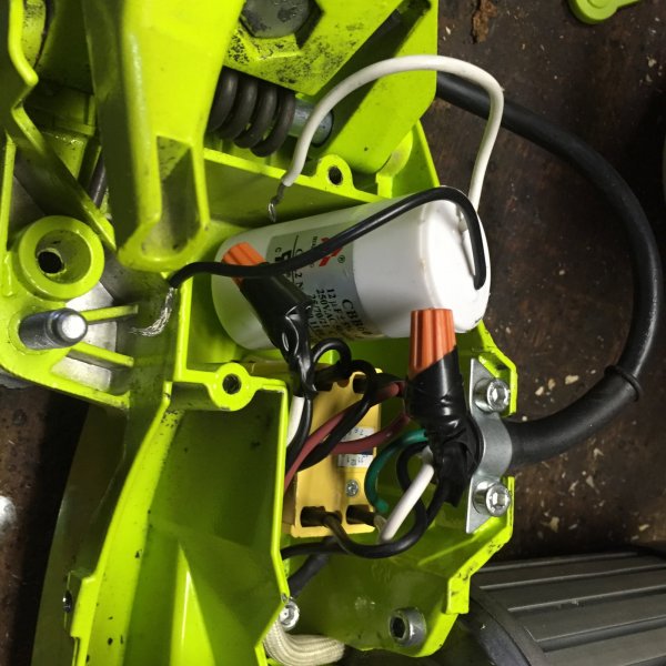

    Take the starter capacitor out of it and it becomes reversible...

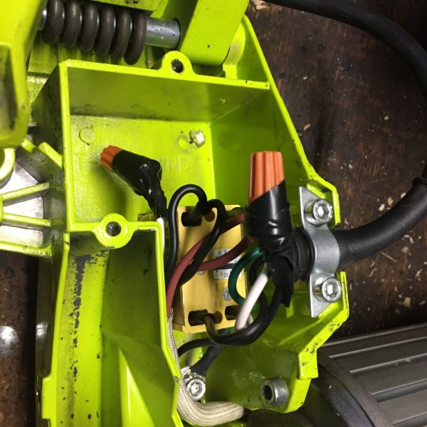

    Take motor cover off.
    Remove big white capacitor...
    Re-land wires minus capacitor in the way..
    Button up..
    Throw capacitor in trash....
    Then when you turn the grinder on, you just flick the wheel in the direction you want it to spin and electricity does the rest..
    HDRock, lukem, clemsonfor and 2 others like this.
