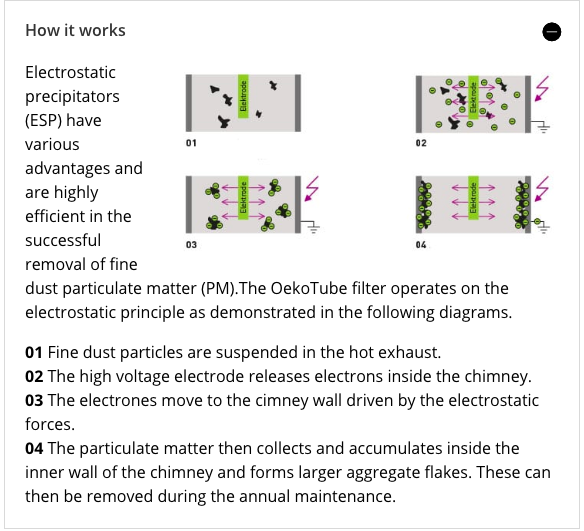

    I'd like to see how the precipitator approach works out, and there are probably longer-term results available from areas that have been using it longer, like in Europe.
    Seems like more cleaning would be involved, to maintain whatever the particulates are captured on..

    So does it re-gen like some tractors or does it swept out with a chimney cleaning?

    Sounds like the electrical charge put onto the particulates causes them to "stick to the side of the stack."
