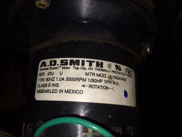

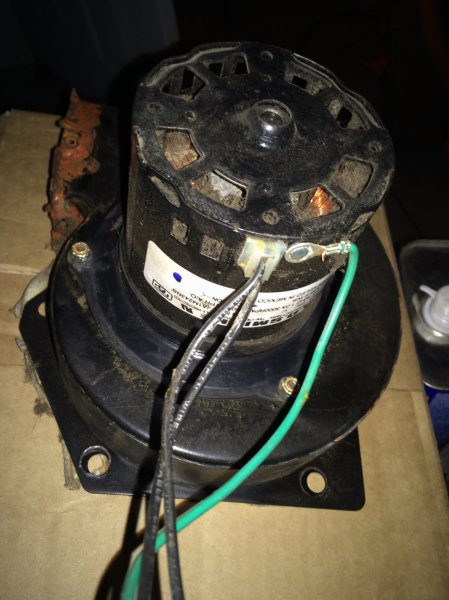

    New HHT Dansons Pelpro Accutron 4 control panel, new vacuum switch. Stove and venting is clean!
    A.O. Smith Exhaust Motot runs fine but look at it!

    Not good at all!

    Yes, the squirrel cage was completely disintegrated!

    Yes, Also when the squirrel cage collects ash it can make noise and be out of balance.
    If you noticed in the video, the new exhaust blower has the petal quadrafire impellers that HHT uses!
    Still no quick change hub for easy cleaning and motor replacement.
