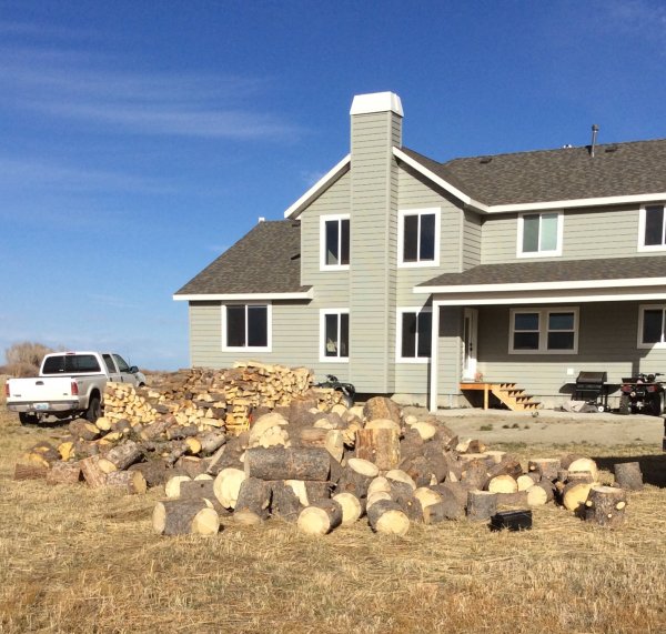

    I would say your off to a great hoarding start already! :yes:
    I was questioning your optimism about 20 plus cords, but I see now, your a motivated hoarder for sure! :)
