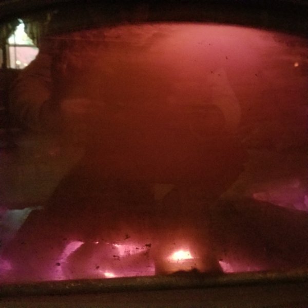

    Welcome Ddio39 . I have a Travis Industries Lopi Rockport. There was a learning curve for me with my stove. (Still learning). When is the wood going black? When you engage the cat?
    There are times when you will engage the cat and shut the air down, that there is no flame. Just glow from the cat. 20211114_143400.jpg
