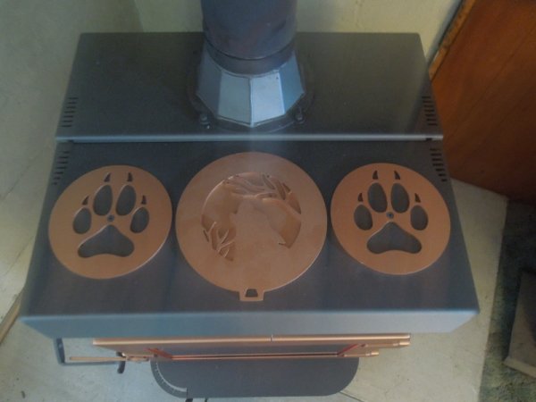

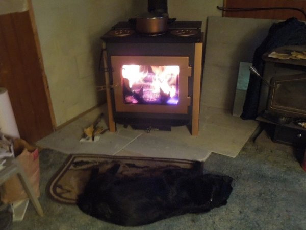

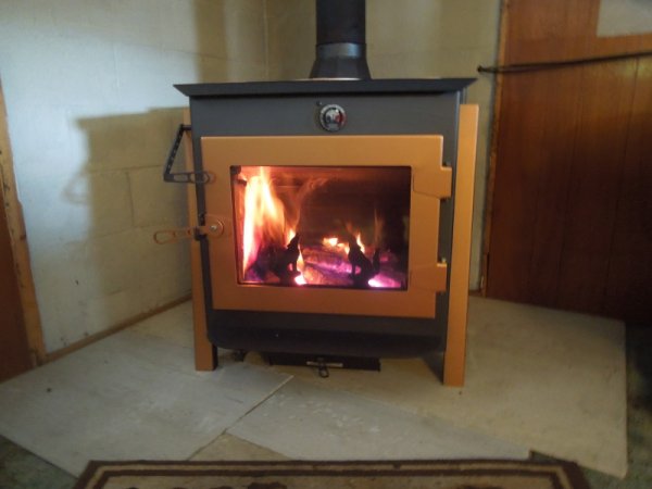

    Trying pics,
    We'll see how it goes.
    New compared to old.
    A beautiful sight.
    A top view.

    Welcome to our family, Chaz! You've bought a top-notch woodstove from a top-notch company, definitely one of the "Lamborghinis" in the woodstove world!
    Your stove is beautiful, and the install looks great! I own Napoleons, so I can't say anything specific I regads to how to run your particular stove, but I will say there is certainly a learning curve in ANY new stove. Try some different loads, try different draft settings, see what works best. Different times of the season require quite different burn techniques with my appliances. I like to load it to the gills when it's really cold, get a good flare-up, and shut her down to a cruise.....when it's milder, I put smaller loads in it,leave the draft open a little more and let it burn WAAAY down before reloads.
