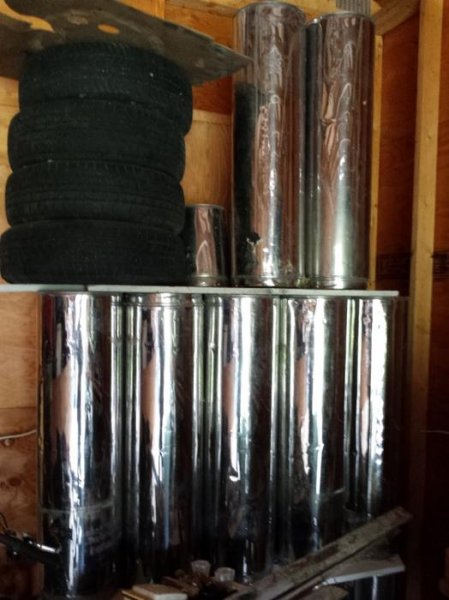

    Hi everyone new here, finally got the wife to ok the wood stove... I cam across a local swap and shop for some double wall wood stove piping. The g uy wanted it gone to make room for this shop. He told me to make an offer so I did for 200.00 cdn and he accepted it...ad stated:
    "I have about 7 36" foot pcs , 5 30" pcs and 1 12" pc. They are 10"od with 8" inner
    Double lined . Make me an offer.I need room in my shop . Excellent for your shop or cabin ."
    Ive attached a photo...can you guys tell me if its ok to buy used piping and from your experience if this would work for my house? thanks!!!

    Well, it's a good deal if it's what your stove needs. I'd check for any obvious signs of breakdown, like seams coming apart.
    What stove are you looking to get? Does it require 6" or 8" flue? Most stoves only need 6", unless it's an older one or quite large or both. You may have less than optimal results using oversize pipe. Some have done it without issue though.
    Brand new 36" Class A pipe runs anywhere from $50 to well over $100/piece depending on brand and place of purchase.
    I need to ask......how much firewood do you have? How long has it been cut, split, and stacked?

    Those are pretty hard to destroy without it being obvious. Looks for seems coming apart. If they have been outside and the shell in compromised, one might be obviously heavier than the others from water. Sometimes the conmection "locks" are all bent- but even those are forgiving so it may not be a deal breaker. If they look good I would be interested in two things-
    1) are they all compatible and compatible with any thimble and stovepipe you already have?
    2) does your stove need 8 inch pipe? If not, I would probably move on. The difference between 6 and 8 inch pipe is huge.

    Stoves that use that pipe are not as common as 6 inch, but with the area you want to heat you may very well end up with one. You could get your money back on that pipe any day so it might be good to pick it up with the intention of selling it later if the stove you pick needs a 6 inch flue.
    Seems are where the pipe meets up with itself. They are sort of crimped together somehow and a good hit can open them up, exposing the insulation and causing a fire hazard.

    I'd absolutely buy used if it passed my visual inspection. Looks like you got a smokin' (pun intended) deal there. Where I sit a 48" length of 6" runs about $85 usd.

    Just because it might be good deal, doesn't mean it's a good deal. There's only a small handful of modern stoves that require 8" pipe. If you aren't looking to heat the whole house, stick with a stove that needs 6" and the pipe to go with it.
    I'd still like to have some info on your firewood situation.
    As Unhdsm mentioned, you could grab those pipes, then sell 'em later for the correct size once you get the stove (presuming said stove doesn't require 8").
    Regency 5100, and Blaze King King are 2 stoves that mostly require 8".
    Here are your PE choices....... http://www.pacificenergy.net/products/wood/
    Oh, and don't forget, you'll need compatible parts to put all that pipe in. Find out what make that pipe is, then match up all the same make parts.
