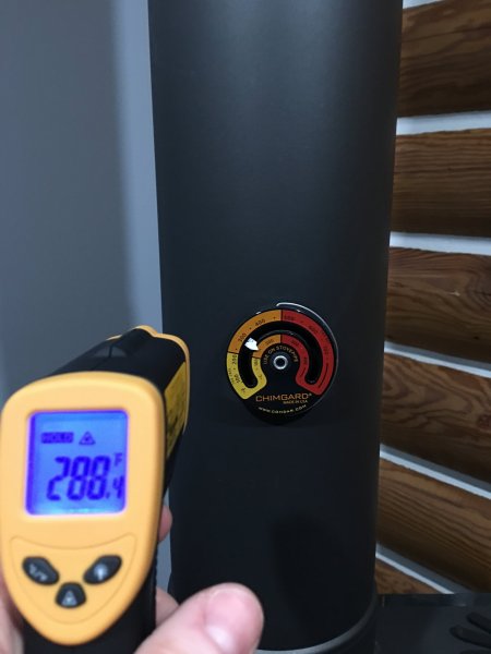

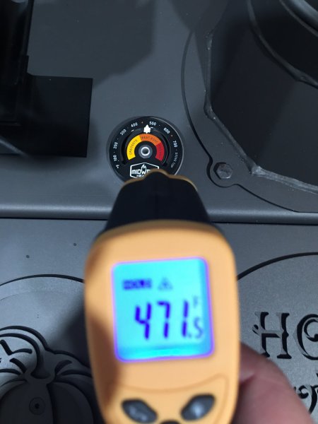

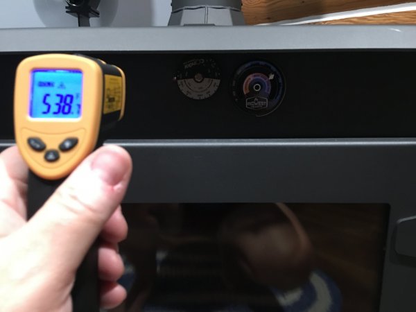

    I’m completely new to burning wood for heat. Got the Ideal Steel running for a week now and not sure of anything. For the first two days I didn’t have any sort of temp measuring device because the stove didn’t come with one as they claimed, had to order some. During the two day waiting period I’ve been doing a lot of reading and figured I needed to get a cat probe and IR gun as well. Anyway, the first two days it seemed as everything was great but it felt very hot and I was concerned with all the over firing warnings. Since I have installed thermometers it seems like nothing is going right anymore. I don’t see the secondary burn anymore, glass has blackened and no matter what I do I can't get a warm fire, it’s always just hot. I’m not sure if I’m engaging the cat at the right time or which thermometer to trust and build a routine from there. In the pics I’m showing the gun reads 538, cat probe 1,500 and stove top thermometer at 650. I checked the chimney pipe thermometer and it looks as if it matches the gun at 288. Maybe I’m just overthinking it but I am concerned about damaging this investment because it wasn’t cheap. Any tips or information would be greatly appreciated.

    I have the midwest hearth thermometer as well as the condar chimgard probe and the same IR thermometer. The midwest hearth seems to match up nicely with my IR thermometer. The midwest hearth does lag behind getting an accurate reading as any stove top thermometer will. My flue probe seemed to read high out of the box. What I did was let it sit out overnight to cool and then adjusted it to match room temp as close as I could. It seems much more accurate now.

    I got same stove so here you go. If pipe is single wall I think it is.
    Make sure thermostat about 16 inches above stove top. Wait till thermostat says about 275* ish

    Those probe type expansion thermometers are not very accurate generally so I would not put much stock in the readings. Plus they are extremely slow to respond. A thermocouple reading device is much better for reading cat. temps. IMO, and much, much faster as well.
    Where are you setting the draft? The I.S. with very good draft will run with the air adjustment fully closed; it does not really every close and the small openings left (front draft along the door glass and secondary draft) are still significant.
    The stove top temp. at 650F is pretty hot- not dangerous but you will not get a long, slow- to- medium burn that way but rather a hot and fast burn. MY I.S. normally runs around 400 - 450F stove top (measured at the hottest point on the stove top) unless it is unusually cold outside.
    As you have an IR temp. reading device, the fastest thing to change will be your stove pipe because it is quite thin. All other readings will lag well behind what the stove is really doing; it takes quite a while to change the stove top temp. even if the firebox / cat. temps. are moving up very quickly.

    Brian, I followed your advice to the letter and it seemed to work perfectly. Awesome advice, thank you. I also moved the stove top thermometer to the stove top just left of the flue collar which is the hot spot, it seems to match up with IR gun in that position as well. When it was time to engage the bypass with the stove pipe returned to 300 and intake set to 1/2, the cat probe was at 1,200. Closed bypass and set air to 1/4, ate dinner, came back to these readings (pics attached)
    Stove top - 471
    Stove pipe - 307
    Cat probe - >1,600 (IR gun says 575 on the face next to cat probe)
    I also checked all of the wood with the moisture meter too, everything between 17-21%
