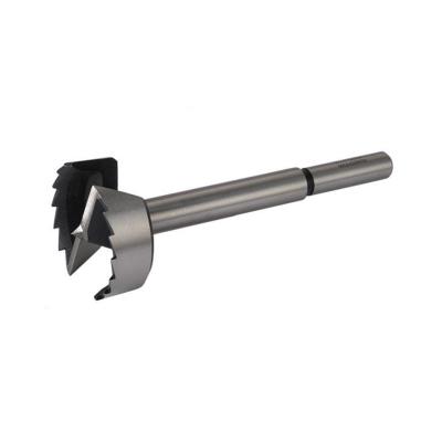

  14. HDRock
    17,248
    60,350
    2 1/2 or 3"
    Buy 2-1/2" Forstner Bit at Woodcraft.com

    If it was me, I think i would make the slices first. Then stack a few, and drill a pilot down the middle. Scribe a circular hole larger than the light bulb and socket on each cookie and cut out with a scroll saw. Cutting a split with the center bored out is dicey unless you use a bandsaw.
    Trying to put a hole down through the end grain of a piece of wood with a Forster bit can be very hard and dangerous too.
