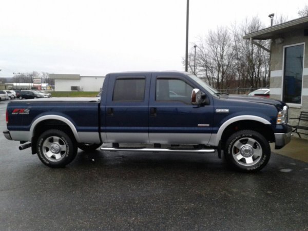

    So with the addition of a new little boy to our family we decided a regular cab s-10 would no longer be cutting it so Sat. we ventured to Marietta, OH about a hour and a half from our house in Fairmont, WV spent the day test driving vehicles and finally decided on a vary nice 2006 Ford F250SD CCSB the check engine light was on and I knew there was not a catalytic converter under it but for the asking price I was prepared to replace it myself they said that did not have a tech to check or clear the code and said it had just had work preformed and the codes had not yet been cleared me falling in love with the truck said ok filled out the paperwork and left with the truck.
    So fast forward to this morning I needed a bearing from the parts store so I decided to have them check the codes threw two codes about the egr they cleared them and I went on with my day about 30 miles later CEL came back on so after doing a little reading I decided to pull the EGR valve and it was wet with coolant and had sludge in the housing witch should be dry and may have carbon like buildup so that leads me to think the egr cooler is bad and the cause for that I read is the oil cooler looks like $1000 in parts and 20-25 hours labor my warranty reads 30 days or 1000 miles on drive-train only I cover 50% of parts and materials. Starting to think I stink at life lol

    It's a crap shoot for those trucks. Best thing to do would be take it back if they'll take it and find another one. You could have a blown head gasket also. Check the coolant level and the oil for contamination. Hope you can get that worked out.

    Sorry to see you already have found the first flaw with the 6 liter. To echo what mdavlee has said, delete the egr, upgrade the oil cooler and stud the heads. After that is done the 6 liter should last pretty good. The head gaskets usually hold up pretty well until you hit them with a little more boost.

    Devin, do some reading, Gale Banks did a lot of work towards making the 6.0L ("sick leaker") a reliable performer. If you HAVE to throw some $$ at it, then check out their research.
    Ford had a program to fix these trucks too no? The EGR and oil coolers were replaced with stainless parts IIRC? Then there is the head bolt/stud issue. But the primary cause of blown head gaskets is the EGR cooler leaking coolant into the intake. Coolant flashes to steam, raises cylinder pressures to ridiculous levels and ......
    Check out this article.
    http://www.bankspower.com/magazines/show/617-ford-power-stroke-6.0l-part-1-what-fails-and-why
