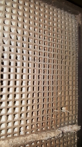

    Just picked up a used Keystone locally and it's in great shape overall, only 5 years old and the previous owner said it was only used for 3. The combuster does show a number of cracks and some small missing pieces. As this is my first catalytic stove I'm not sure what life if any is left in it. I was planning on buying a new cat for the stove but figured I would check before I do. This is the old style ceramic cat.

    That cat doesn't look that bad. I'd try it.
    Given the price of Woodstock cats, I'd also get a replacement. Because you will eventually need to.

    I'd agree with Jeff, I'd give it a run because you will have a learning curve with a cat stove so may as well try to get that with the old one.

    Looks like normal ware and tear for a 3 year old cat. Probably has a little life left but I think I'd just start out fresh with a new steel cat so you don't get frustrated with poor light offs or poor performance.
    Does this stove have the new stainless scoop protecting the cat or the older cast iron with expanded metal screen? You may want to replace that as well if its the later.

    That cat still has some work it can do but I'd pick up a new one anyway because you don't know for sure how long they will last once they start cracking. I like the steel cats as they light off quicker and no worry about crumbling. They also tend to last longer.
    When at Woodstock, I'd also ask them about the kit they have which has about everything you will ever need for maintenance on that stove including all the gaskets and it is a good price.

    I "tried" to learn to run a cat stove while absolutely ignorant about them, coming from a pre epa stove. I think I am actually more confused after trying to get a crumbled cat to work. If I could do it over again I would have started with a new cat.

    It really depends upon how badly the cat is. For sure though, once they start to crack, it does seem to take a hotter fire to get the cat to light off.

    Start with a new cat. And seasoned wood. 20% moisture content or less.
