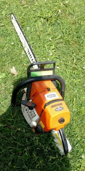

    That's the one thing that's mostly turning me away from stihl synthetic is it stinks like crazy, the price however doesn't matter to me, not that I can just throw money around but the fact that if I spend an extra $10 a year on better oil and premium non ethanol fuel to keep all the saws out of the shop for carb problems or worse that extra $10 pays dividends. My biggest worry is just switching, but like I was thinking, it sounds like it's no big deal to play around with different oils.

    Stihl ultra is a fine oil, however if the smell bothers you use what you usually do.... "I" use stihl ultra and have for years, on all my saws that I have looked into have looked great... Plenty of lubricant and no excess carbon on piston, which is a problem with to much oil in mix not burning off.....sounds like you take care of your equipment, so you will be perfectly fine.... Nice lookin saw too!!!!
