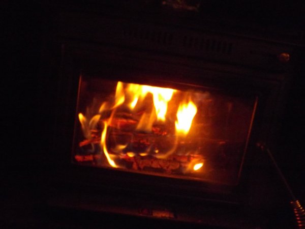

  11. wildwest
    30,262
    142,326
    Wyoming high plains
  12. bogydave
    OK. Read the thread & saw the ugly pics
    Out with the old, in with the new
    From the forecast
    Seems it'll be putting out heat just in time.
    Impeccable timing !
    Stay warm :)
    burndatwood, wildwest and rottiman like this.
