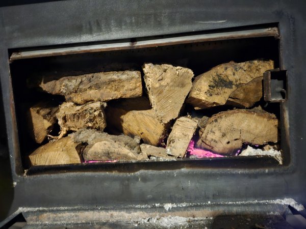

    Our Drolet Blackcomb will take 18"-20" E/W and 11"12" N/S. We cut both lengths. We'll pull coals to the front, put a nice 18" round or split in the back "valley" the fill with shorts N/S. Gets a long burn time then... 20241204_232556.jpg

    8+ hours for a burn time that way?

    We have gotten 8 hrs of a big load with good wood. We burn a lot of chunks and scraps, so 6-7 hrs mostly. The Blackcomb is a smaller to medium size stove.
