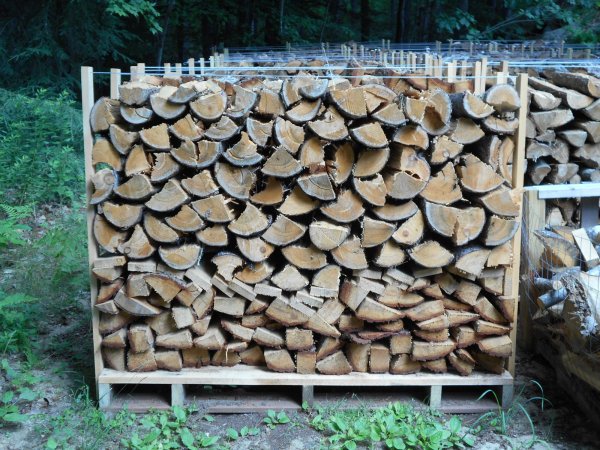

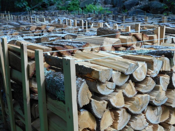

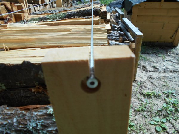

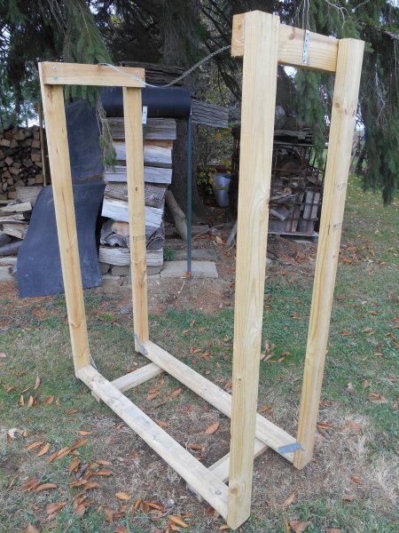

    my friend devised this wood storage/moving method ,a simple wood frame with 2 pieces of steel cable in kerfs in the top to prevent splaying ,he moves them with forks on a small kubota DSCN0038.JPG DSCN0038.JPG DSCN0037.JPG DSCN0039.JPG

    Pretty cool. I'd probably just use a little shrink wrap.

    good idea just looking for a good pallet supplier as most will not hold up. ?

    And it can double as clothes line.:rofl: :lol:

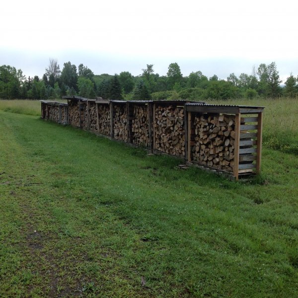

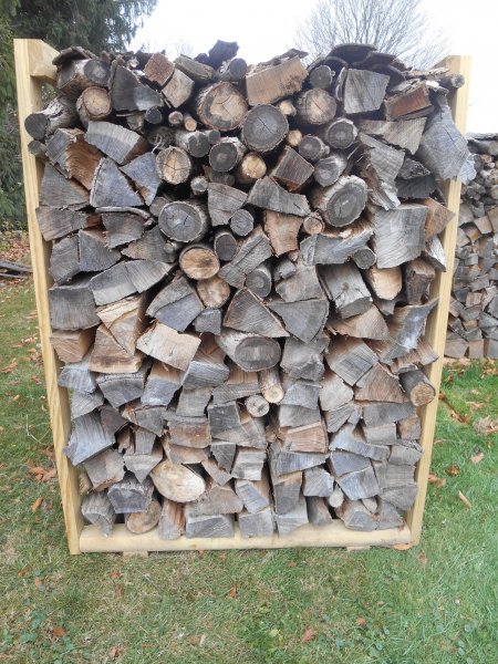

    This is basically what I did, only the racks are not as wide, and the steel is plumbers tape instead of a cable.

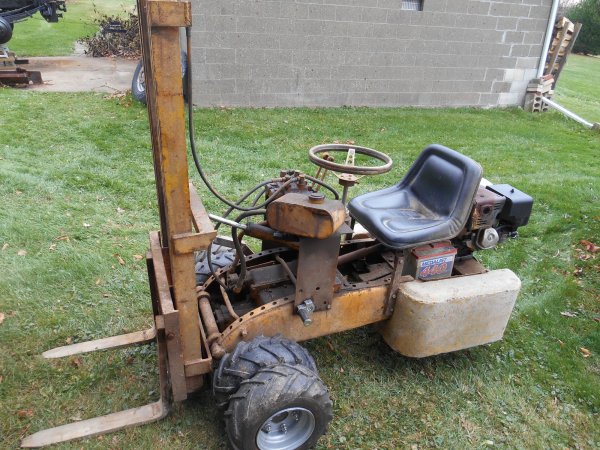

    That little forklift is awesome

    :thumbs::bug::woodsign:
    ....and, I want it.

    It's a handy lil bugger for a homeowner/firewood hoarder...too small for somebody doing commercial firewood or something like that. I wanted something small, as garage space is at a premium here (I only have 2 garages :whistle:) and the price was right..(free from my dad...it was sans engine)

    That's awesome! I want to get my dad set up on a system like that. That's a sweet little forklift!

    Very nice. How did you make the cables, or did you purchase them? If purchased, where from?
    And I agree, the forklift is cooool.
  11. unclefess
    unclefess Guest
    they were made from bulk cable

    Any method of CSS that reduces the times one needs to handle the wood is a good system IMO. Ditto on the love of the forklift.
