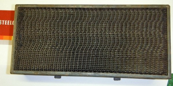

    Old combustor was the original stainless that came with the stove 5 years ago.
    I did put a ceramic in 3 years ago. it lasted 2 years, the center section fell forward.
    it worked ok like that but when I took it out for cleaning, it cracked & fell apart in pieces.
    I had to put the old stainless one back in. It worked ok.
    Took it out this Fall, for cleaning. cleaned & put it back in.
    I ordered a new one, it came yesterday.

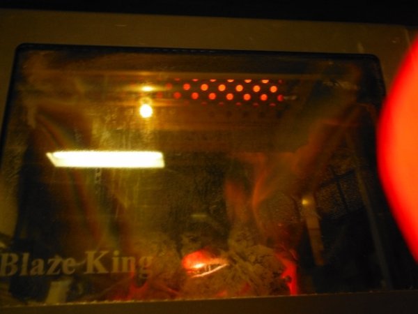

    It lights off fast, glows like when the stove was new.
    Had a great burn last night (20° f here ) still glowing & in the active range this AM.
    Going on 14 hours for the burn cycle with good heat output.
    This AM pic after 14 hours:
    Not sure when the efficiency drops off , but I notice a significant improvement

  5. bogydave
    My old original cat was still glowing, but nothing like the new one is.
    not even close to how this one is glowing on low.

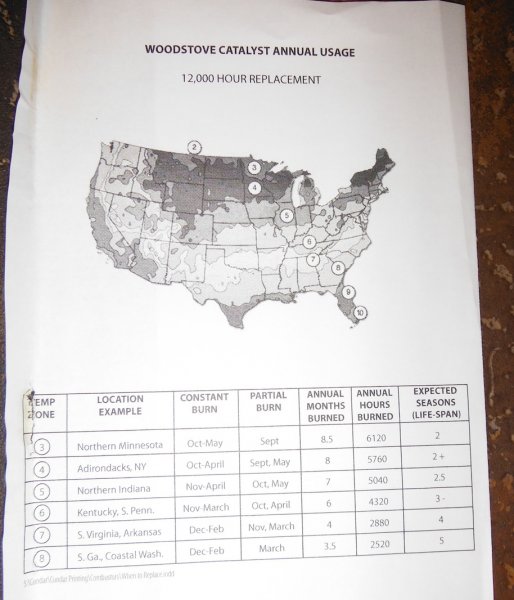

    Applied Ceramics says my Firecat combustor should last 6 years but with proper maintenance could last 10. I couldn't find anything on how much it degrades like Condar says but they say one of the biggest problems is saturation of potassium from the wood, I also remember Tom at Woodstock telling me about this and this was one of the reasons they went to the s/s screen scoop which reduces ash build up on the cat and extends its life.

    OK, according to Applied Ceramics they consider 6 years to be 10,000-12,000 hours. Seems like those hours wouldn't last me 6 years if I burn 24/7 for pretty much 4 months straight.

    Yea
    A more real world, honest warrantee should be written in burning hours.
    The honest test might be the one that shows 25% reduction of catalytic function after 12,000 hour.
    25% loss of efficiency is significant.

    I would install a new one. SS or Ceramic
    After 5 years & your long burn season.
    Over double the hours of what's recommended , gotta be time .
    I never noticed a fall off of performance, it's a real slow one over time.
    But this year, real noticeable drop in heat output & slow to light off.
    New cat, I'm back to running hotter & longer burn times.
    My opinion is the SS cats are better.
    But I had problems with the ceramic.
    I liked the performance of the ceramic, the bigger holes pass ash better & I never had any issues of it plugging up.
    but after it broke, I'd be leery of taking it out for cleaning.
    I had more fine fly ash when burning spruce, I was vacuuming the original SS one often.
    No problems with spruce ash plugging the ceramic one .
    If you are having good luck with the ceramic, no need to go with the more expensive SS ones. IMO.
    But for a few ext buck, you could try one. Backwood & I like the SS ones.
    Finer screen though, & you burn lodge pole, might have more ash.
    I believe they wear out. The 12,000 test seems logical, nothing lasts forever.
    That baby is glowing red hot for thousands of hours. gotta take a toll over time.
    For install, need some of the high temp tape to wrap around it.

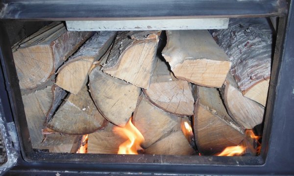

  20. bogydave
    Had a little left over from last nights load.
    Long burn times are back.
    20°s, to be around 15°. Clear, no wind.
    Tonights load:
