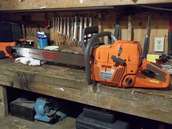

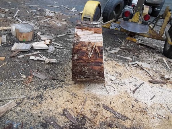

    Brand new 390 husky, new chain, new bar. Cut is running sideways. What's the problem being caused by?

    That issue is usually due to cutters being dull on one side. On a new chain?

    Has me stumped! Wondering if it's the wrong bar and the grove is too wide?

    Got the bar & chain #'s?

    Make sure the bar us square, it would be odd though being new. I've had some new chain with the depth gauges all over the place, if they were low on the right hand and hugh on the left, that sure would make the saw cut bad.

    Groove may be worn on the bar Tim.

    Oregon Skip chain ?
    Chain size not match bar size ? ( .050 bar & chain? )

    Checked the chain looks like new not even a nick on one cutter .

    Can ya rock the chain back and forth in the bar? Thinking the groove is wider than the drivers.

    My friend the issue is with the chain or the bar. Not sure what the dealer will be able to do other than point you in the right direction, maybe offer to sharpen your chain, or set the depth gauges properly. Do you have to torque on the saw at all to make it cut?
    If I had to guess this is probably the longest bar you've ever ran before? Longer bars exaggerated small problems with poor chains and bars, that wouldn't be a problem on a 20" bar & chain. Can we get some nice clear pics of the cutting teeth of the chain. I've seen many chains that the owner claimed were perfect, that were actually totally rocked out.
