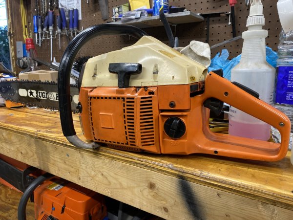

    76533FCA-62C0-4C22-996B-A29B109A4A68.jpeg 65B84636-9274-4B38-BA17-42ABF14423AD.jpeg Father in law gifted me his old husqvarna practica 61 in the spring. He cut hundreds of cords with this when he lived in the country. He doesn’t cut firewood anymore and any things that have to be done around his house are small and I can do it for him. I put a new plug in it and some fresh e free gas and it fired right up, put it on the shelf till’ last night. Got it out, cleaned it up, new bar and chain on it. Went to fire it up and gas is leaking everywhere! Probably a rotted fuel line. I’ll look at it further once I get my bench cleaned off. I know they made tons of these and it’s not rare or anything but it’s my first “old” saw. Probably won’t use it much because it’s got no chain brake, but from what I gather they are a reliable workhorse of a saw. Just thought I’d post a pic for y’all.

    Old skool cool! :thumbs:

    That's a beauty of a saw. I say fix it and run it like it was built to be run.

    Nice. If it runs, then use it.
    It's not ready to be a wall hanger.

    Cool saw! Parts are everywhere for these, and alot of parts for the bigger 2 series models will work on the 61.

    You should be able to get a brake for that pretty easy. Maybe not an original metal handled one, but a functioning one made for the 61 chasis.
    I’ve got a white top 61 also. Pretty cool Rancher

    Husky white top 61. Nice saw. Just remember with a saw that old not only are the fuel lines old but so are the crank seals and intake boot. So keep a close ear to the tuning when using it.

    The old 61 is a good saw and the start of all the 2 series huskies from 60-72cc, that one will have a 2 piece ignition with coil and separate trigger. Hasn’t been available for some time but I have used the Chinese copy and it’s been working for couple years in the two I tried for neighbors saws.
