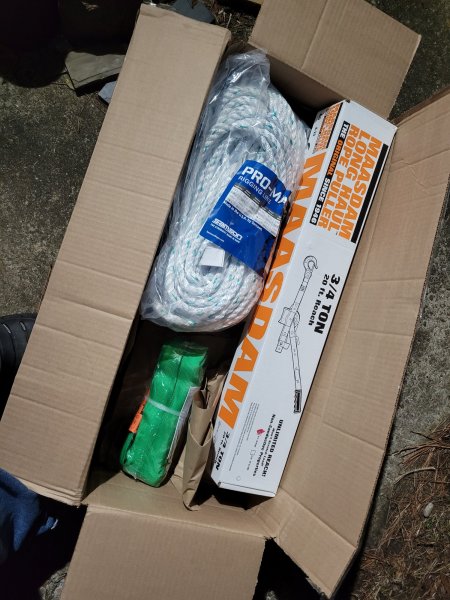

    Well, this isn't really "power equipment ", unless you count manual crank power.......
    I've cut trees before using a standard cabled come along and chains. Saw this one day and when I could get it on sale/discount, decided to pull the trigger.
    I want to add a snatch block in case I want to change pull angles. Having a bit of a time finding one for 1/2 inch rope that isn't too bad $ wise. And I think I need to get some strong caribeners. If anyone has a lead on some that aren't crazy $$, please advise. I got the puller kit from treestuff, but their blocks and caribeners seem a bit pricey to me....

    I bought that same kit a number of years ago. It's worked well for what I've used it for.
    I got 150 and 50 ft of rope for it.

    I went on and got the 200. Only used chains with the old comealong....not used to rope at all.
    I figure I'll use a small strap wrapped around whatever I'm pulling and attach pull rope to that. I'm thinking a caribener is what I need to tie to the end for attaching it to that strap?

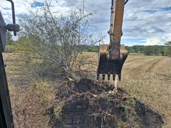

    20230926_144939.jpg Had to do some tree tipping the other day my self. About 40 acres of company mine site land littered with honey locust, willow and cotton wood. I chose the easy way out though. 20230926_145935.jpg

    I know pretty much nothing about rope in regards to what you're talking about, as I'm sure you can tell. Is the Samson rope in the pic the kind that spirals?
    And that alpine butterfly thingy sounds grand! But other than that it also sounds Greek! :rofl: :lol: :thumbs:
