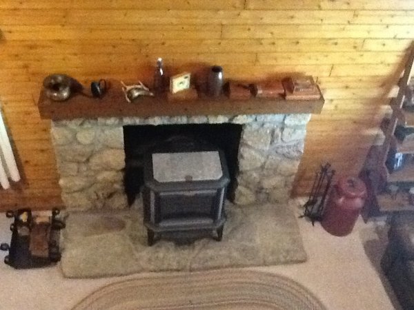

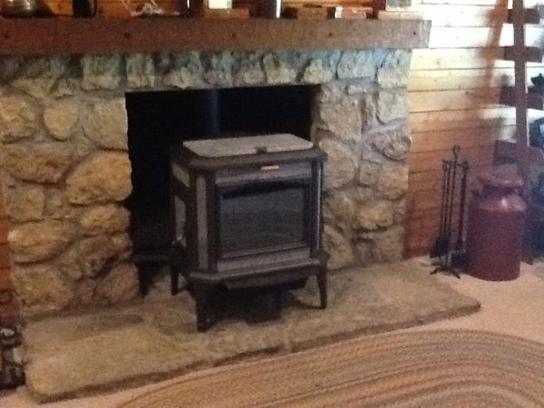

    Busy weekend with moving the wood stoves and also everything else that I needed to get done around the house. Several friends came over and we moved out the T6 and placed the PH in its place.
    From the stairs looking down
    From the spectators seat.
    I still have to get the pipe hooked up in the back. Also, my stove to mantle clearance is less than 30 inches. I will check if I need to rework the mantle or simply put a heat shield order the mantle. It is warm out so I am not going crazy wanting to start the fire. I will post more updates as the pipe and mantle issue is resolved.

    Looks great, congrats! How many inches from stove top to the bottom of the mantle?

    I'd definitely put a shield on the mantle.

    17 inches. Heat shield will go in before a fire is lit.

    Yeah, you put a heat shield on there in you'll be all good to go

    quick question Ohiosteel: What kind of pipe do you have going up the fireplace. I have the flex liner for my insert. If one were to pick up a new hybrid stove and ran the same set up as yours, up an existing chimney, would the chimney need to be re-fitted with the rigid pipe instead of the flex liner or is there some kind of adapter?

    The chimney was lined last year. 6 inch liner. Flexible but smooth interior. Block off plate above lintle and new cap.
    It will be fairly strait forward to connect the stove. Once I get the heat shield / deflector for the mantle I will be burning off the new stove stench.
