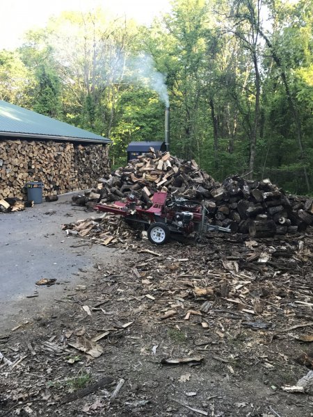

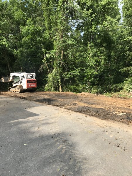

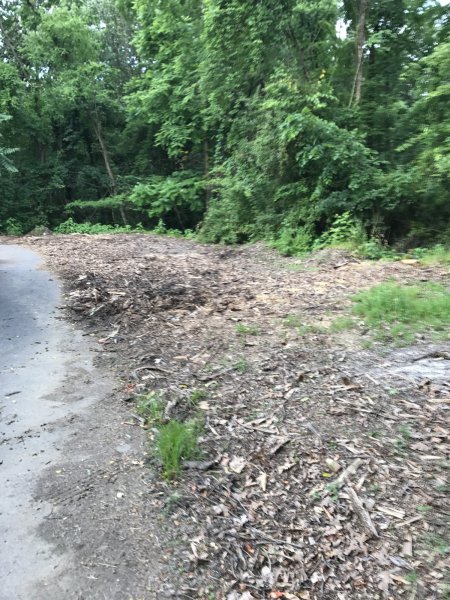

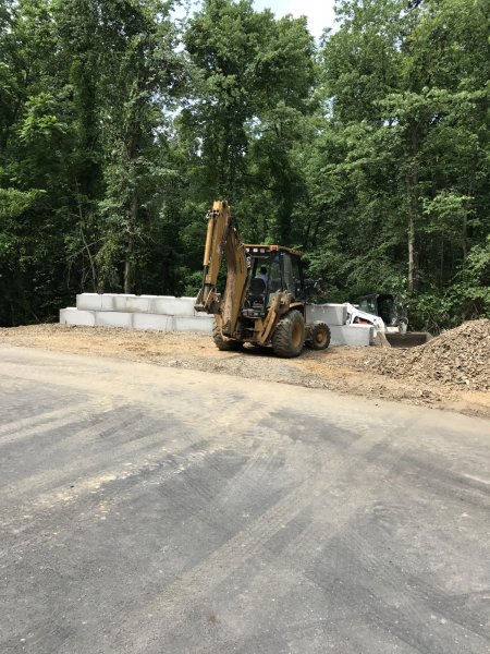

    IMG_4010.JPG IMG_4011.JPG IMG_4012.JPG Pad expansion project underway. Added some shale and will be building far wall out of some barriers I got. Planning for wall to be 42 feet long at bottom layer, then 36 foot second course, then 30 foot top course.
    Once paved I hope to have nice working area that I can then scrape clean with loader out the open end. More pics to follow.

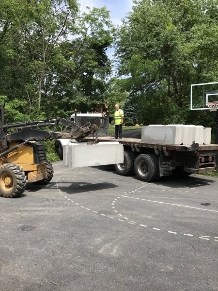

    80 bucks each
    But you need big loader to unload. 3600 pounds each

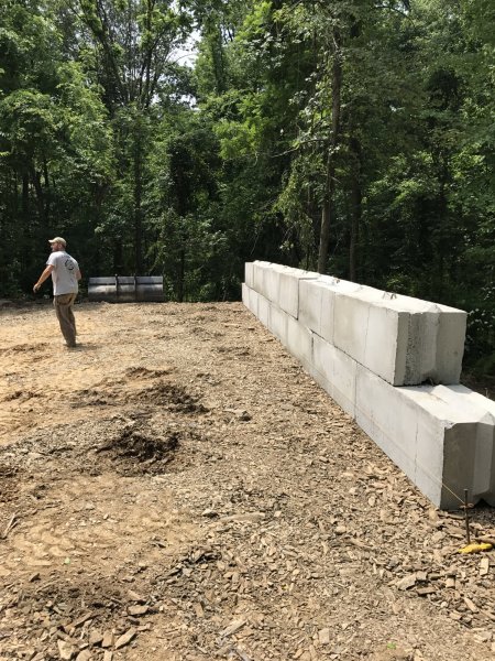

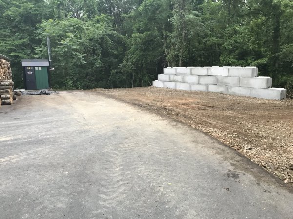

    Wall and rough grade done, 2a modified layer and blacktop next week

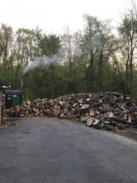

    IMG_3853.JPG IMG_3929.JPG Under normal hoard mode, the pad has a back slope on the short top side and long far side, wood sort of spilling over
    Pad stayed muddy a lot and was pain to work on and move gear around on etc
    Wall is helpful to hold edge of paving in, as lower blocks will be buried 7 inches once complete
    I always wanted a fixed spot to push against with the loader vs the moving pile
    Then my plan once paved is to be able to scrape with the loader out the open end
    Lastly, not sure why, but I just think those walls are cool and wanted to try one!

    Those blocks are cool! I've used them for retaining walls into a hillside and then for the "foundation" for the back wall of a building, a "headwall" for a bridge, material bins and anything else your imagination will allow.
    They'll certainly stay in place just scooping up wood against it. I've seen them stacked 4 high (8') with sand piled against them to the top, nothing but air on the other side. Good old weight & gravity working for ya, unlike me in the AM. :eek:

    These are cool. 6x2x2, rebar handle, and triangular slots on bottom, top and side to sort of lock together. If I wanted a solid building I'd throw these things up and put a roof on it.

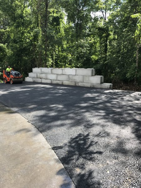

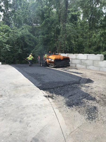

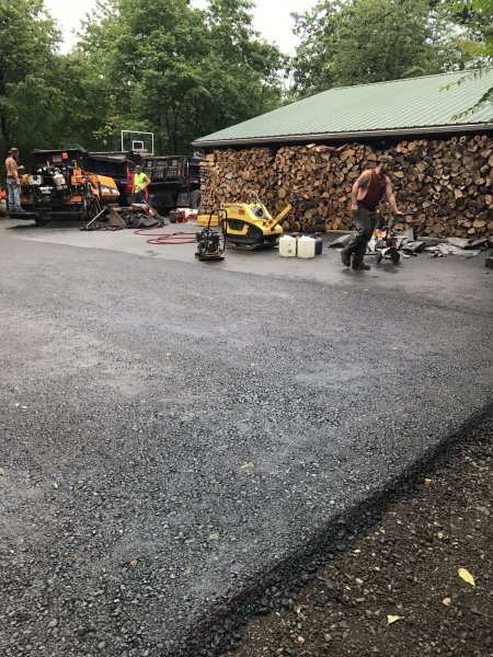

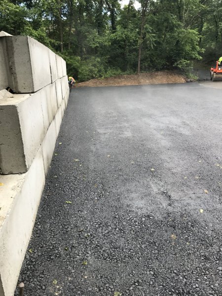

    IMG_4035.JPG IMG_4036.JPG IMG_4037.JPG IMG_4038.JPG All done, waiting 48 hours to cure, then the pile will be starting again, will have a trailer load I think tomorrow night that I'll leave loaded until ready.
