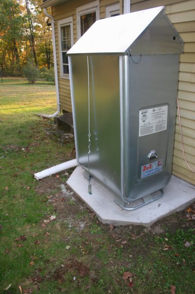

    We just installed a 2 in 1 oil tank to replace our inground tank that our insurance company is hasling us to remove.

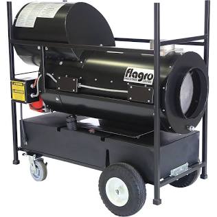

    The place I work at uses these heaters for enclosed construction spaces in the winter. IMG_5196.jpeg t
    They get bounced around in the back of trucks from site to site and constantly run out of fuel. We were constantly running around all winter fiddling with them to keep them going. Installed Tiger Loop systems on them and it dramatically cut down on issues. I also have one on my oil boiler(was there when we bought) and haven’t had any issues with it tho I’m not completely sure why it was originally installed.
