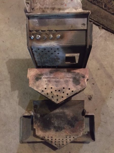

    Here are some pics: IMG_1840.JPG IMG_1841.JPG IMG_1842.JPG

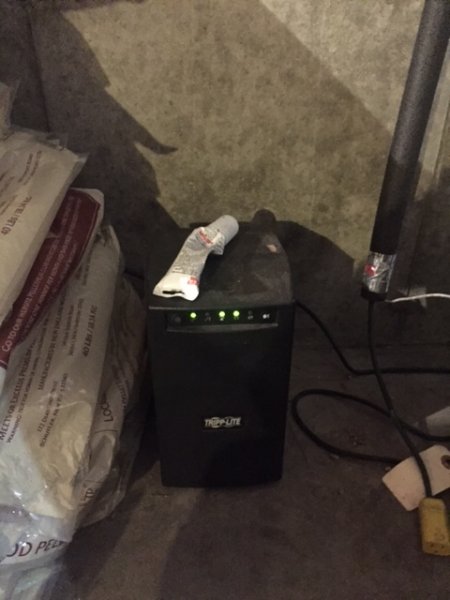

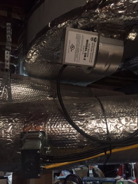

    Please forgive the mess - so in the pics you'll notice a couple goodies...pic #2 shows what I believe to be a requirement if heating a large house with long runs, that being booster fans (I have 2 pointing down the main runs @ 300cfm/ea) tied into a pressure switch - they turn on/off with blower. This add-on really moves the heat around the house and into my 22x22 greatroom at one far end. Pic #3 also shows what I believe to be a requirement - a UPS (it's 1500w and will run the furnace for approx 15 minutes - enough time for me to get the geni running during our all too often power outages). Pic #6 is one of my fabricated parts - the stock re-light plate was a constant PITA for me - I run 4-6 ton/yr and mid-season, without fail, it would buckle and cause jams - this is my spare as I have my first fabbed peice in the pot and is still looking great after 2 years - same dimensions of original, so the steel they are using must be really cheap - will fab SS units next (actually, will do the whole pot in SS over the summer - should have came that way IMHO). Pics #5 & #7 show it running on heat levels 1 & 5 respectively (sorry for the poor quality - glass is original and I never really clean it as it's in the basement) as I run off a T-stat.
    You can also see my pittiful attempt at blocking some of the blow-by on the main door - saw some upgrades using latches - I like that idea!
    It's running OK now - but my pellets are a huge dissapointment this year - so even with the pot upgrades and sealing the extended hopper It's not running as it should.
    I don't have the larger exhaust fan/moter, manifold or sail switch upgrades. I'll buy the switch from Fahrenheight, the manifold is something I'll tackle now that I've seen pics of it (nothing my plasma cutter & welder can't handle). I've seen the fan online...guessing it's the 4.5" version...question is does it really need the larger motor to spin it?

    One of the biggest issues in the design is that front burn pot door...it takes a beating and seals for sh*t. I'm going to modify the pot frame and weld in tabs that extend the air passages into that door...basically help the air get through that door...I suppose you could put a gasket on those surfaces, but I'd like a more perm solution...

    You can adjust the actuator push/pull length by disconnecting at the slide (that connects to the pot). Pull that cotter pin and counterclockwise should shorten the throw. Which will pull the front door in tighter. Only do a half a turn at a time. If you go to much? And it closes? Then SNAP!!
    I love your mods!! And the booster fans are a great edition! I'd love to see more on how you wired those up!

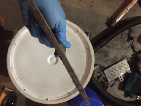

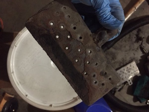

    DexterDay...I'm with ya on the actuator adjustments...issue is...if too loose you get crappy seal, if too tight, that door/and or retractor arms take a beating..I think I have a solution, but need to play with it during the off-season.
    Above are pics of my very recent pot upgrades (stolen from Dex...welded) and my fabed re-light plate that has held up considerable better than the Fahrenheight units.
    oh...and my serrial # is 2684
    Funny (well, not really) story...I was able to take those pot pics because I saw the flame looking ugly...re-light plate had popped out of the arm and was hanging over 1/2 the pot...upon further inspection...the studs that hold both the pusher and re-ligh plates in the actuators were bent and I couldn't re-assemble...thought I had seen everything...but my 50F keeps throwing me surprises. Once again...cheap steel...the pusher is all stock Fahrenheight and the tail section (with the studs) on the re-light plate is also Fahrenheit steel (you can see my weld in the re-light plate pic). I know what I'll be doing this weekend...finding high grade replacements...
    The wriring for those boosters was pretty straight forward. I know this because I did it and I'm no electritian...ah, not even close...
    I used a good grounded extension cord, there is an outlet on my main furnace, so just wired from outlet to pressure switch, then from swich to each booster. Just need to drill a small hole to mount switch...boosters take a little more effort but come with handy templates to help with the install. I do all my own HVAC work, so getting cut up is part of the fun :D

    That style has a one piece bottom. Where mine is split into halves. But lacks the driver for the front of the pot. That is connected to the front on the V-4 units.
