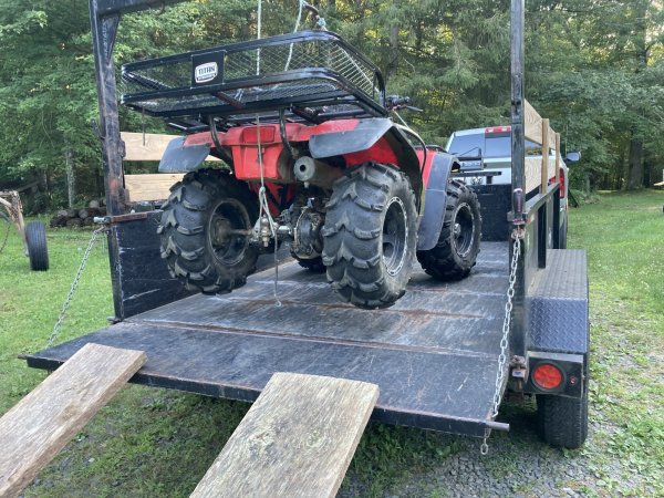

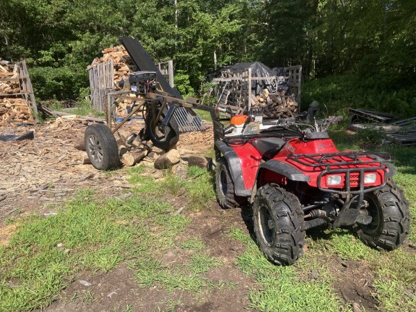

    A continuation of the tractor thread. Went with an old crude Honda Atv as a backup to my Polaris.
    Well it’s old and crude, no doubt. It does run well tho. Changed the oil and spark plug first off. Judging by the plugs apparent age I then decided all the fluids should be changed. Two differentials and a transfer case. Fairly certain they were original fluids in those. Hard to say what those fluids once were, they did t look like a lubricant I ever saw LOL. Basically muck.
    I flushed all three while running with kerosene to get even more muck out. It’s better than thy were. Front differential was almost dry, bad seal I assume. I’ll watch everything for leaks.

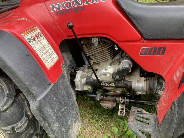

    Tried engaging the Warn 424 drive system,,,,,now that I know what it is,,, it engaged but makes a clicking noise.
    Reading the web that night I noticed the OEM tire size. I knew they put larger tires on but originally the fronts were two inches smaller than the rear. Now they’re both 26” That’s not good, can’t do that with a 4wd. So I jacked up all tires off the ground and ran it. No clicking, runs nice, all four tires engaged. I was afraid the whole thing was torn to shreds in the front. Think I may as well try two new tires in the front,,,,or maybe rear, properly sized and see what happens.
    Took it a for a couple mile ride in the woods. damm it’s rough. Polaris is like a Cadillac in comparison. I’ve dropped the tire pressures down to 1lb and that’s better. These tires have sidewalls designed for a machine twice its weight.
    It won’t do anything better than the Polaris but it also doesn’t have a computer that decides when vacation time is :)

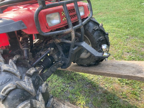

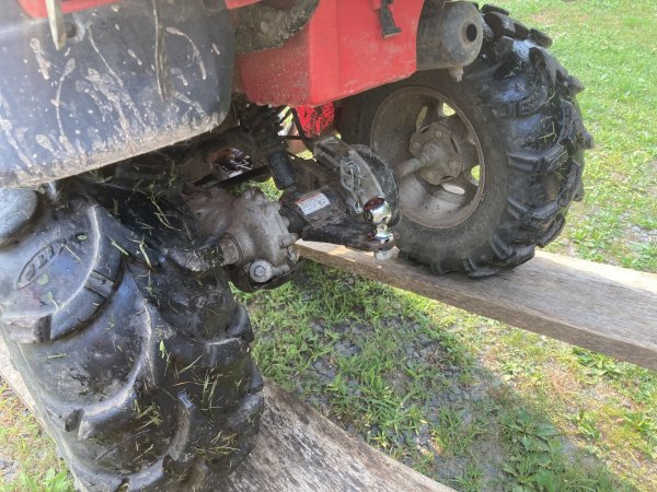

    Occurred to me that just running it in the air empty may not tell me the whole story. This is what I came up with for a way to put some pressure on the front drive line without the rear LOL
    Yeah just spinning on steel but it pulled pretty hard. No clicks, no gnashing of gears or splines. Think it’s still ok. The seals in the front differential leak, probably melted from the wrong size tires on there. It’s worth ordering two tires to see if the 4wd will work.

    How tough are the seals in the front differential to replace? Should I assume bearings too?

    I would say you have about a 50/50 shot on the bearings being bad...front diffs usually hold up pretty well on those, but she does have some age on er now...

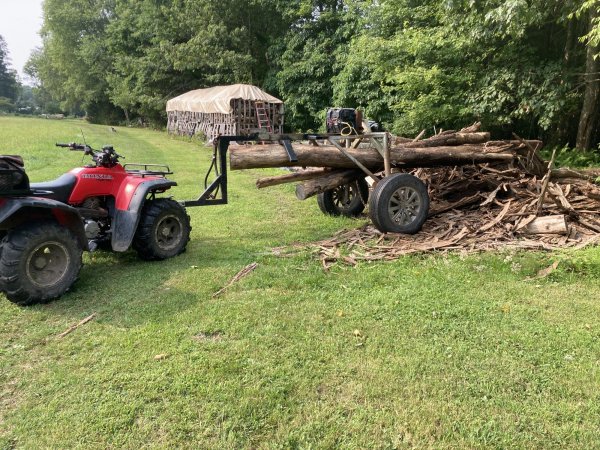

    So today I decided to try the arch in front. I like it for light duty moving on flat ground, easier to see and maneuver. Not sure why I never tried it this way before,,,,. In the woods it’ll probably remain a pull maneuver. If it ever disconnected from the ball while pushing things would get exciting fast.
