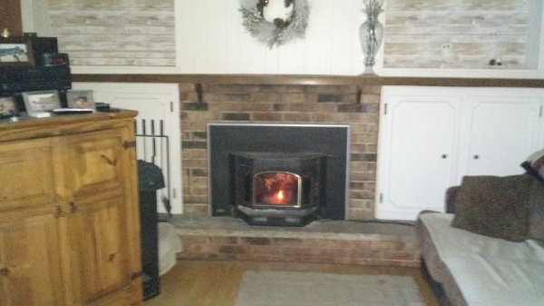

    Well we're a bit north of you in Wisconsin, but we have a similar style house. L shaped ranch, with all the BR's on the far end of where the existing chimney was. We have some new windows, but a few are old and inefficient. Our insulation isn't that great either for the whole house. I have a furnace in the basement, but our Quadrafire 4100 wood burning insert really is the primary heat source. Inserts work great, you really can get the house cooking with ours, and I think many of them are very good heaters.
    In your case, I'd say an insert would probably be best. There's flush mount inserts, bow front inserts ( like mine) and ones that stick out a few inches with a traditional front glass pane.
    Here's my Quadrafire 4100i in my living room. My wife was extremely picky about which insert we could get. She's very happy with this one. I installed it myself, with a little help from a buddy. IMG_20170315_070419943.jpg
    Regardless of which direction you go, you'll need to get dimensions of the fireplace.
