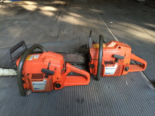

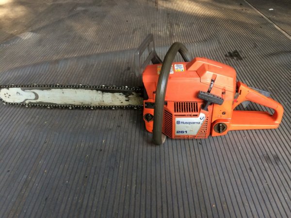

    Found this 261 today, P&C are very nice and started on 3 pulls. I also got 3 used (up) chains with it. Should clean up fairly well.
    Here it is with the 272 XP I picked up over Memorial Day (which still needs to be cleaned).

    Very nice Gary. Id really like to have a 272 for the collection.

    Great saws there !! They look in really great shape !!!

    Here is to hoping those hit the block here 1st ;)
    Nice saws Gary!!

    Very nice saws, I have yet to go to the dark side and add an all orange saw to my arsenal.

    Nice
    20" bar ?

    Those are nice looking saws Gary, nice score(s). :cool:

    Put a 262XP piston in the 261, then run it. It will put a smile on your face and no ache in your back.

    Dual port the muffler, use the three shoe 262 clutch, use three bond for a base gasket, and replace the 144 carb with a Walbro HDA-87 (if you can find one). Smile some more!

    How many cc's is the 261?

    The 261 and 262 share the same bore and stroke 48x34mm or 62cc the main difference is that the 261 has a dished piston and the 262XP has a flat top pisto giving it more compression. The very first models did not have a Mahle C/P they used a Kolben/Schmidt which had a slightly smaller combustion chamber and even higher compression.
