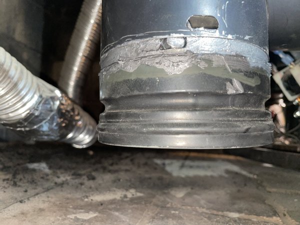

    Yes, I have had that problem too. I have a Duravent T on my stove that is not removable at all - even with a chain wrench.

    I think a lot of the problem with mine is the installer used an RTV sealant to prevent any leaks. That's ok though. I can take off the one outside and brush in from that end.
