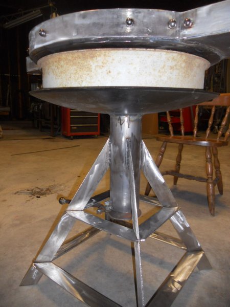

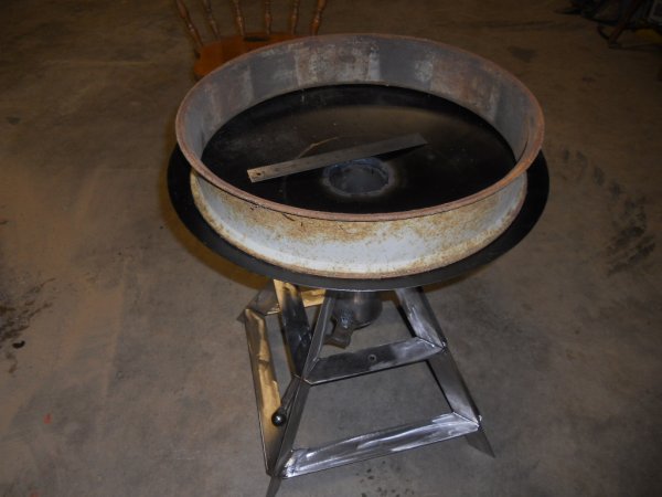

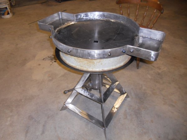

    After sitting in a corner of the shop for a few months, got to finish it!
    I don't want to fool with a burner & tank so I plan on using brickette's or charcoal. The fire will be on the lower disc surrounded by a ring that the upper cooking disc rests on. I have a 4" pipe running into the bottom of the fire disc with a damper on the bottom. Do you guy's think it will burn without a smoke path other than a not so tight fit between the ring. I'm thinking that will really keep the heat under the disc.
    I thought that I'll try it with first "burn off" fire and see what happens. From what I understand you want pretty high temps for this type of cooking, and with the cooking disc resting on that ring, I thought that (if the fire burns) it'll get good and hot.

    Fuelrod,
    Way cool man! Great Build
    I am no engineer nor do I pretend to be one. But, from my experience with HVAC systems it seems to me that the only vent "relief" hole is at the center of the top pan. I would think the heat will be pretty intense right there. If that's what you're going for then you're probably good. Otherwise, it will be like trying to blow air into a paper bag. Just my input.

    I have to agree, I think I was a victim of wishfull thinking. It just almost seems that charcoal brickette's almost do that, just melt away with no real smoke or fire action. I'll modify that ring before I burn it off today.
    That hole is getting filled Marty, it's the last thing I need to do. These (discs) are just replacement disc for a regular (ag) plow disc.

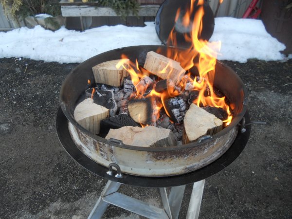

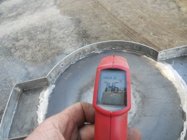

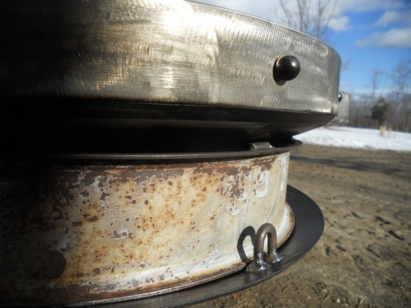

    1/4" gap gives me a few sq/in more than the 4" air intake. It worked with wood chunks! DSCN7835.JPG DSCN7839.JPG DSCN7838.JPG

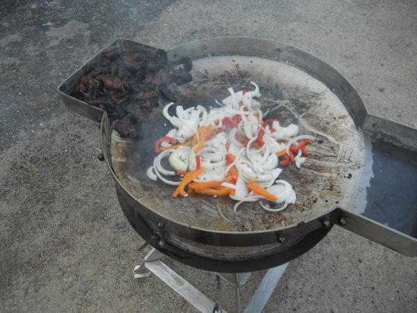

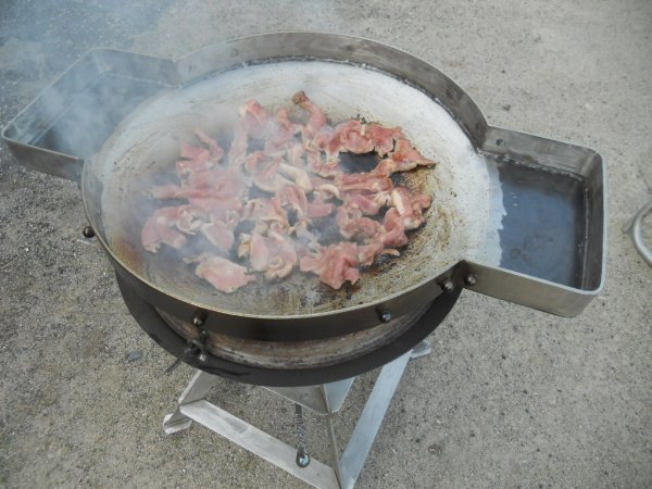

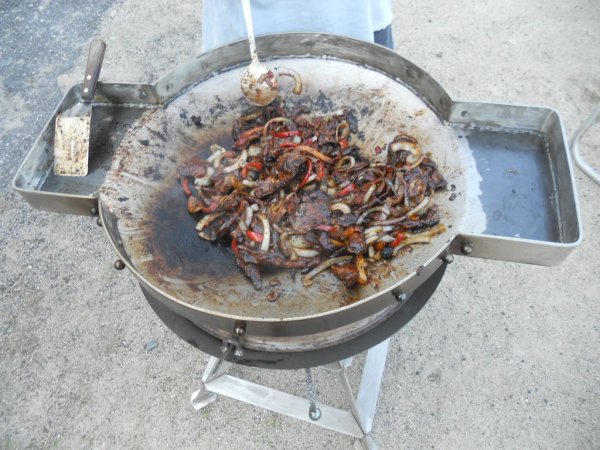

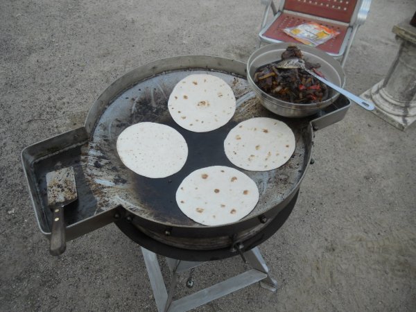

    First cook - finally!
    Sliced thin a pork TL. S&P, a little hot, a little maple syrup & whatsthishere sauce- browned. The pics tell the rest. DSCN7967.JPG DSCN7969.JPG DSCN7971.JPG DSCN7977.JPG DSCN7979.JPG

    Our lard rendering kettles only have a loosely fit shroud surrouding them, and the smoke finds its way out just fine. Well, now we use a 500,000 btu propane burner, but it does the same. I think your openings look better than adequate....and letting it escape all the way around the perimeter probably makes it heat pretty darn evenly.
