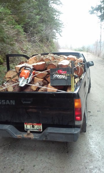

    This is the truck and in this picture she is underloaded i would usually have the first two rows of wood about a foot over my cab

    Got any side profile pics?
    Steven Stern likes this.

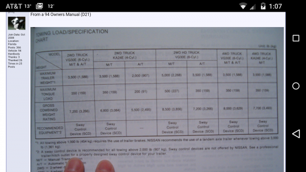

    Looks like 3500 lb max trailer weight. Here's a screenshot for a manual from a 1994. I think the 94 was pretty much the same as a 91.
