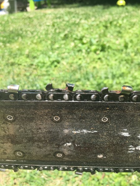

    Does this work or do you need a lengthwise photo? Thanks chris

    Rakers don't look like they have been touched and it is hard to see but does not look sharp either.

    Lots of meat left on there. Find yourself a progressive raker gauge. They should be a bit lower that they are now. Is there a witness line on he top of the cutter? That’s a good indicator of how far back you can file.
  6. The Wood Wolverine
    17,953
    114,076
    Progressive is one that butts against the tooth in front.
  7. The Wood Wolverine
    17,953
    114,076
    Don’t go past the lines they provide as a filing guide.

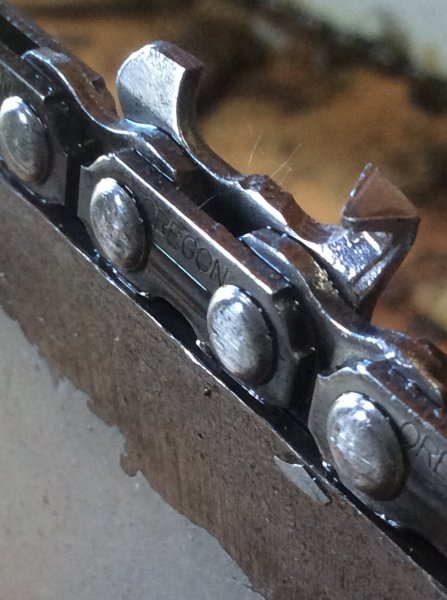

    I got this chain with a saw. I’d saw it’s given all its had to give. Just short of the guide line.

    You can run it till the teeth start breaking off, if ya want. :saw:

    Your chain is very dull

    I gotta agree with everything said above...plenty of life left in the chain, it just needs a good sharpening, with proper raker adjustment...

    Interesting, I had a sharpening session with six file passes on the cutters and six passes on the rakers. I was afraid I was going too aggressive on the rakers and admittedly don’t quite follow how to properly set the rakers height even with the tool that came in my cheap sharpening set. I did run the saw through some rounds before I took the photo including some noodling and some less than fresh cherry wood.
    Like I said, it was throwing some good sized chips when engaged. And the chain has seen a fair amount of abuse. When I first borrowed the saw it was throwing dust and smoke and I didn’t know any better, and it stretched out a fair amount. The neighbor I borrowed it from also didn’t seem to know much about maintaining a chain. He seemed to think you just had to buy a new one periodically. I’ve been sharpening it before every use now and have the bar oil dialed to about a tank per tank of gas. Just switched out the air filter. But I also took down those cherries with some mud tubes a while back.

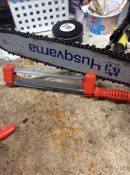

    I like this one. And it lets you choose the files size. Just pops out of the handle there and replace with the different size.

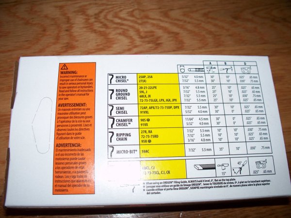

    That's a pretty aggressive cut...most gauges set the raker to 0.025"
    1/32" would be kinda close at 0.03125", but 1/16" is 0.0625" and that would take a lot of power to pull off, and be grabby! :startled:

    I believe this chart is from Oregon®
    Shows .025 - .03 depth depending on the chain.
    .0625 might rip the saw from my hands.
