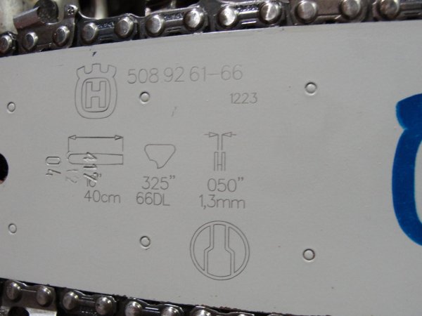

    Chain size info should be stamped/etched into the bar towards the rear side.

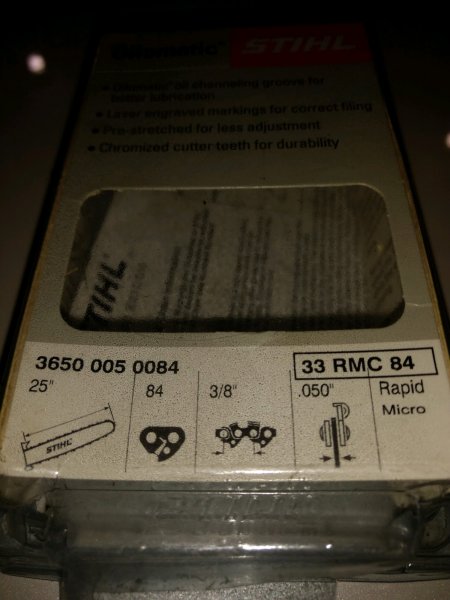

  4. TurboDiesel
    16,198
    97,198
    look for a number of (like 72 for a 20" bar)
    (drive links) stamped on the bar
    here is a chain for my 25" bar.
    84 links

    Oregon 20 66.Stihl RM 23 66. Bar translation is: 16".325 pitch and .050 kerf (width of groove").Stihl website has a "how to" which explains it all.
    That is not the OP's sizes,just the ones which ir the other posters pictures.
