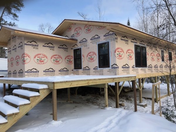

    Thanks everyone for your feedback. The cabin is in progress. Got it framed, Tyveked with all windows in last fall. Haven't had a chance to get back there yet this spring since its on an unplowed logging road and there's still 2 feet of snow. Here is my cabin as of Nov. 2017.
    I'm going to go for the AS. I'm sure I'll be back on this site for coaching on how to burn low and slow.
    Woodstock has a 1 year return policy so if it cooks me out and I can't figure out a solution, I'll just return and get a Survival model.

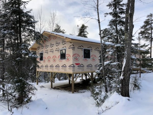

    Here's a couple pics of the cabin.

    Very nice!
    Welcome to the club , TBoone!
    I think your gonna like it here!
    With that raised ranch you'll want to boil water on the wood stove at all times. It will be dry for sure.

    Nice looking place. Roughly where abouts ? Insulated floor? I'd hope!

    Nice cabin! I bet you’ll be able to regulate that AS just like you want.

    Great looking place there Boone.:salute: Don't worry about overheating as the stove can always be pinched down enough.:yes:
    Now invest in a 4 wheel with plow so ya can enjoy it year round.:coldone:
