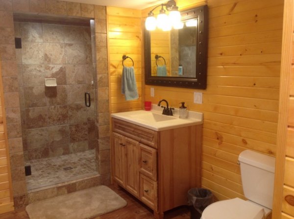

    We really needed a bathrooms upstairs, so decided to take a very large closet off our upstairs bedroom and convert it to a bathroom. Started out as a basic project, but then decided to build a shower instead of buy a prefab fiberglass or plastic unit. Took a long time but finally got r done. Wife's happy. :)

    Nice work Fanatical1 . I remember you posting pics from some of your earlier progress, it really came out great.
    Something that starts out as a 2K project turns into 7k quickly. How well did your budget work out?
    wildwest and Fanatical1 like this.

    I could have used your expertise on this project! I think I have just over 4,500 in materials. My big issue was plumbing. The sewer line needed to run down through an inside wall downstairs and then we pounded through the concrete slab to find the sewer line buried two feet under the slab. Cut the sewer line and put a saddle on it to connect the sanitary drain. We did all this inside of a 6" inside wall. I hired a contractor/plumber for that job.

    Nice job. I like the tiles u chose for the shower. Looks good. Nice looking mirror

    Thanks, Home Depot for the tile and Lowes for the mirror. Both were reasonable. The knotty pine was milled by an amish sawmill close by. One of the benefits of Vinton county Ohio. :)
    The shower door was difficult. Didnt expect that to be one of the bigger issues, but it was.

    You say the glass door was difficult, did you buy that or have it made by someone??
    If you purchased from a box store/internet, do you mind sharing where you got it...Thanks!

    Doors like that one are usually custom made to fit the hole and are typically 3/8" tempered glass. You need your hole to be square and doubled up with 2x4's or 2x6s to support the weight. I couldn't find anything I liked at HD or Lowes etc... They all had a frame and I wanted frameless. Both Lowes and HD will custom order one, but they wanted about $1,000... I found a place in FL that was half that cost and they ship all over the US. Install was a little tricky too, as the door fits tight and it can chip really easy.
    The door swings in or out and self centers itself.
