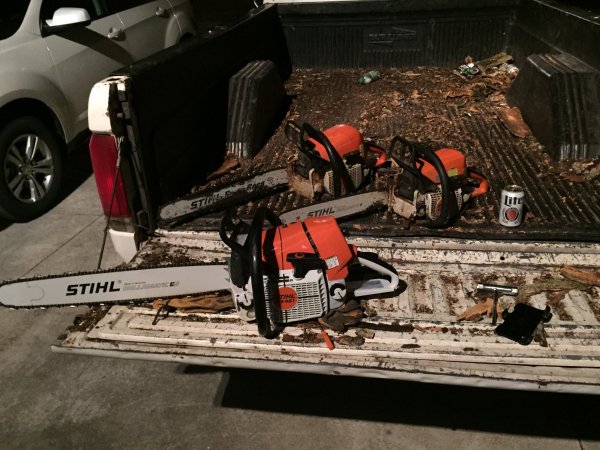

Hey guys just to show you guys I am for real, and I do listen to all who have more knowledge than me, here are some picks of my 250, ol 290, and the new addition the standard 461.... I bought her with the 25"B&C..... I also bought a 20 B&C... I also got 2 or 3 chains per bar.... My price out door was $1000 with the 25B$C....anyway here are my ladies in the back of my 89 f250 wood truck, and yes that's a beer in the pic, I like to work hard and have a beer when I done.... Call me old school.... Anyway thanks a lot guys and I did run the new 461 today at half throttle.... Does anyone have a method to braking in a brand new saw.... Some say run the saw like you always do, and some say baby them for the first 3 tanks of gas, any info on break in much appreciated....
I just run um. Maybe tune it a little rich for the first few tanks. And congrats on the new addition!
Run it wide open in the wood, avoid revving the pizz outta it (out of the wood). Keep a sharp chain on it. You're much more likely to do damage running it at part throttle. These little carburetors are not optimized for part throttle. They have an idle circuit and a high speed circuit. That's it. The best break in is wood big enough to make it work some and longer (10-15 seconds or more) cuts.
Ok master tech, you do t think u have done any harm with the first tank do you.... I am cutting tomorrow til ol lady goes to work and will give her a real work out... And elder l on the miller light...it's better than nothin right!!!! Lmao you guys are on it!!!
