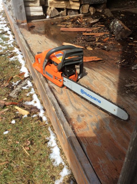

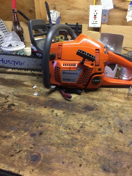

    IMG_0742.JPG IMG_0743.JPG IMG_0744.JPG IMG_0745.JPG IMG_0746.JPG IMG_0747.JPG
    Came across a CL add.
    The saw was advertised as new, never used.
    Made a deal this morning. I didn't steal it, that's for sure.

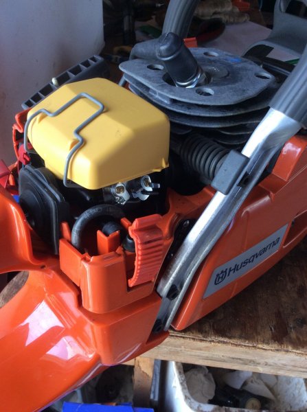

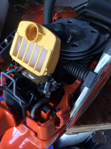

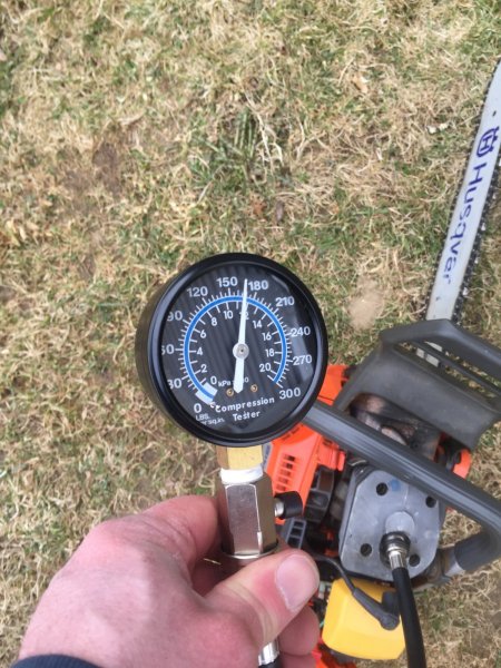

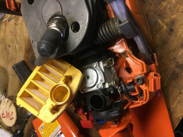

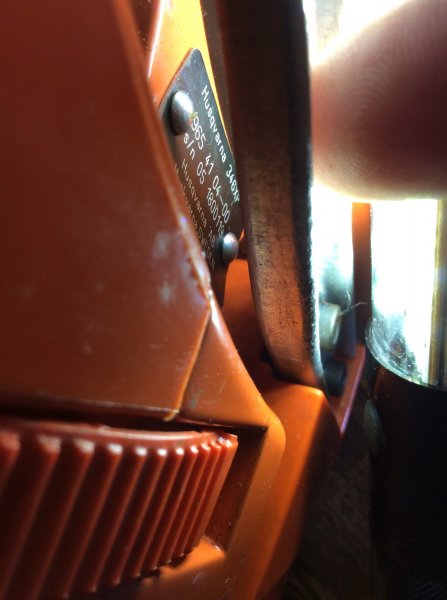

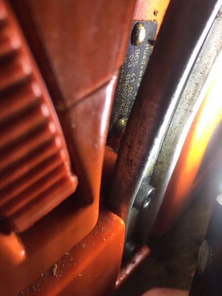

    Funny you should say that! I was posting a couple Homelites on CL this afternoon, not even looking around for anything when an add caught my eye.
    So I picked up my second 346XP in as many days. And this one was a very good deal. He couldn't get it started, so it became an even better deal. Almost embarrassed to say. But he was setting the prices.
    I still can't get it to kick. I don't think I'm getting spark.
    I don't see any anyway with a plug I know is good.
    Crazy crazy!

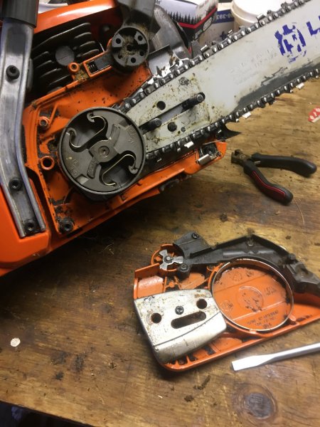

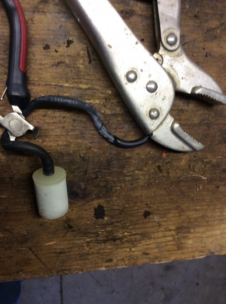

    IMG_0765.JPG And here was the problem. It wasn't spark. I guess I need to look closer.
    I thought the gas I was smelling was a flooded cylinder because there no spark. When I got home today the garage smelled of gas. So I looked around a little harder and I pulled the cap which must have broken a vacuum because fuel started dripping on the clutch side. Ran up to the local Husqi shop for new fuel line and filter. Replaced it, gave it a bunch a pulls with no luck, went inside put food on the kids plates, wife came home with number 3 so I went back to pulling it over and it popped about 4 pulls in.
    Running now! Needs a sharp chain and probably a new bar, nose sprocket is noisy. It's a nice saw.
