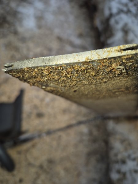

    20251029_144809.jpg I've had this bar for at least 4 years.
    Never had the slightest Hint this was going to happen . And I had put on a new chain 1/,2 cord before this happened .

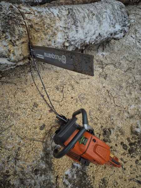

    MAF143
    Dec 8, 2018
    1,670

    Has to be a metallurgy issue.

    Was that mostly composite where it snapped? or was it mostly steel there?

    Interesting right at the point of the dogs. Sugi makes them. I've only known Sugis to have breakage back by the mount holes thusfar.

    Right at the end of the dogs too. I’m guessing it gets lateral stress there a bunch.

    As I was bucking that fat Birch log , I could feel the cut just starting to close and was bringing the tip out to run it back in . Like I always do as I'm bucking . All the sudden the saw started vibrating violently and making a weird Bad noise i instantly popped the brake and shut it down and realized the powerhead was no longer connected to the whole bar . But , the chain was.
