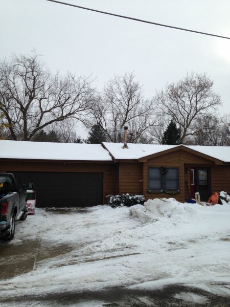

    Sorry for the crappy picture; but this is a chimney from my neighborhood. If his truck wasn't in the drive, I would've taken a few more pix. Normally this chimney is coated with soot down the pipe, onto the the storm collar, then onto the flashing and then down the roof to the eave. What you don't see from this picture is that the chimney is leaning away from where I took this at about a 10-15* angle!!!! Often times I see a fresh load of rounds dumped, then a day or two later, they're split and stacked ready to smolder in his stove!!!! IMG_0353.jpg

    And look how short that chimney is. For sure there is a disaster in the making.

    For sure!!! The part of the roof where his chimney exits looks like about a 4/12 pitch roof...............same as mine. And mine exits about the same place up the pitch also.........................but I have about 7.5ft. of class A above where it exits my roof to get the minimum recommended chimney height for my 13NC. ]
    Just saying of course!!

    When he has a chimney fire, just hope and pray your home isn't too close to catch fire itself.
    And I hope he can get out in time. How do you nicely say to your neighbor, "your doing it all wrong"
    without pizzing him off.
