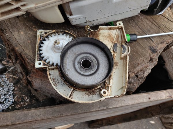

    Took apart my Stihl 028 WB AV today after watching a video last night and seeing how a neglected needle bearing just disintegrated into a mess that jammed up the clutch sprocket.
    It was pretty easy - removed one screw holding the plate covering the oiling hole, a few T25 or T30 (can't remember) screws holding the plastic plate in, and carefully removed the c-clip on the sprocket.
    When I pulled the plastic cover off I was surprised to see a white plastic gear fall out. I figured out pretty quick that was to turn the oiling pump. It was pretty darn dirty in there but I guess not too bad for 35 or so years old.
    Cleaned it up carefully with a microfiber cloth and some carb cleaner and also used a wire brush a few times.
    Used a bit of white lithium grease for the plastic oil pump gear as well as the needle bearings. My tree guy happened to stop by and I showed him what I was doing and he interjected and said "You know, you can just buy one of those grease guns and push the grease right into the spindle...." I told him I ordered a 3-pack of the Oregon grease gun....but that upon inspection of the spindle I did not see a second hole on the shaft!
    Pretty dirty.....

    Here's that white plastic gear for the oil pump. You can see the needle bearing on the shaft on the 2nd pic.

    ive only seen needle bearing greasing through the crankshaft end on Husqvarna and not all. It’s a good idea.

    That plastic piece ( 1118 656 1500 ) is NLA from Stihl . You may be able to find it at chainsawr.com ,or ebay , etc ... . Or, maybe pull it off ,and repair it with super glue ,and epoxy .

    Grease that bearing every 20 tanks or so. Probably once or twice a year for most firewooders. Nice looking saw.
