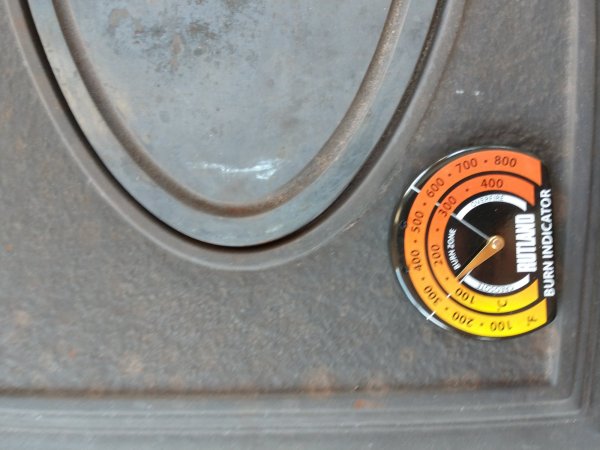

    Also I bought a Rutland burn indicator.
    I have double walled pipe so it says to place it on the stove top. Is this sufficient? 15179423551261956711796715028708.jpg
    My digital thermometer reads 400 on the same spot
    Well Seasoned and wildwest like this.

    Placement of thermometer on stove top is good. If you want one for the flue you'll need a probe.
