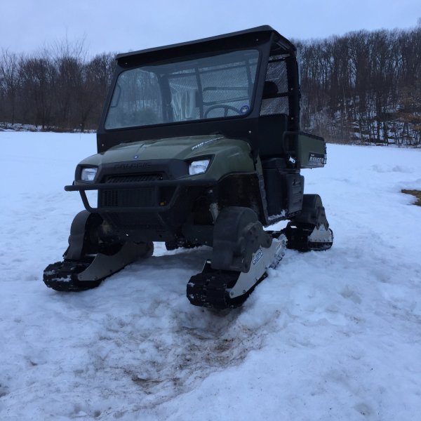

    Last year I found a set of tracks that I can use on the Ranger. It was the end of the season but I was able to try them out:
    My plan when I originally bought them was to be able to use the Ranger for packing the trail down. Up until now, after building the sides up on the "luge" we would snowshoe up and down the track a bunch of times to try to pack it down and then it took several runs on the tubes to get the track going good. I plan to pull a weighted roller behind the Ranger to pack it down. We'll see how that works out...
