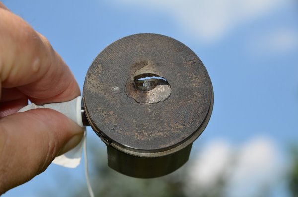

Definitely use the rope or impact gun methods ............................... do not use a piston stop tool. I used a stop tool a bunch of times until I did this to my 460's OEM piston!
